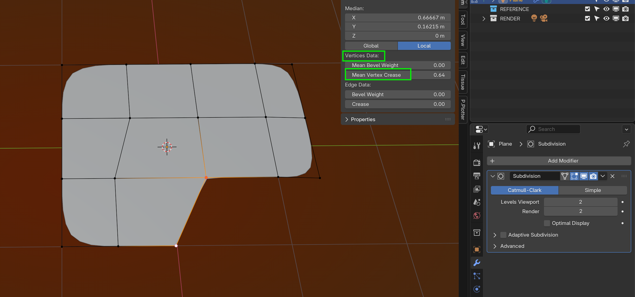

    The simplest way, would be to use Vertex Creasing:

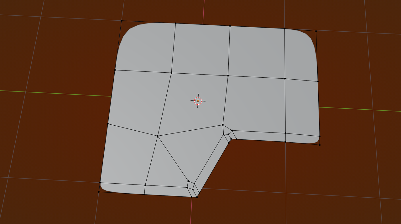

    But you can also use ‘holding Edges’, maybe something like this:
    Be aware of the 5-Pole this creates; make sure it’s on a flat part of the Mesh, or see if you can remove the Vertex (picture-) left of it.
