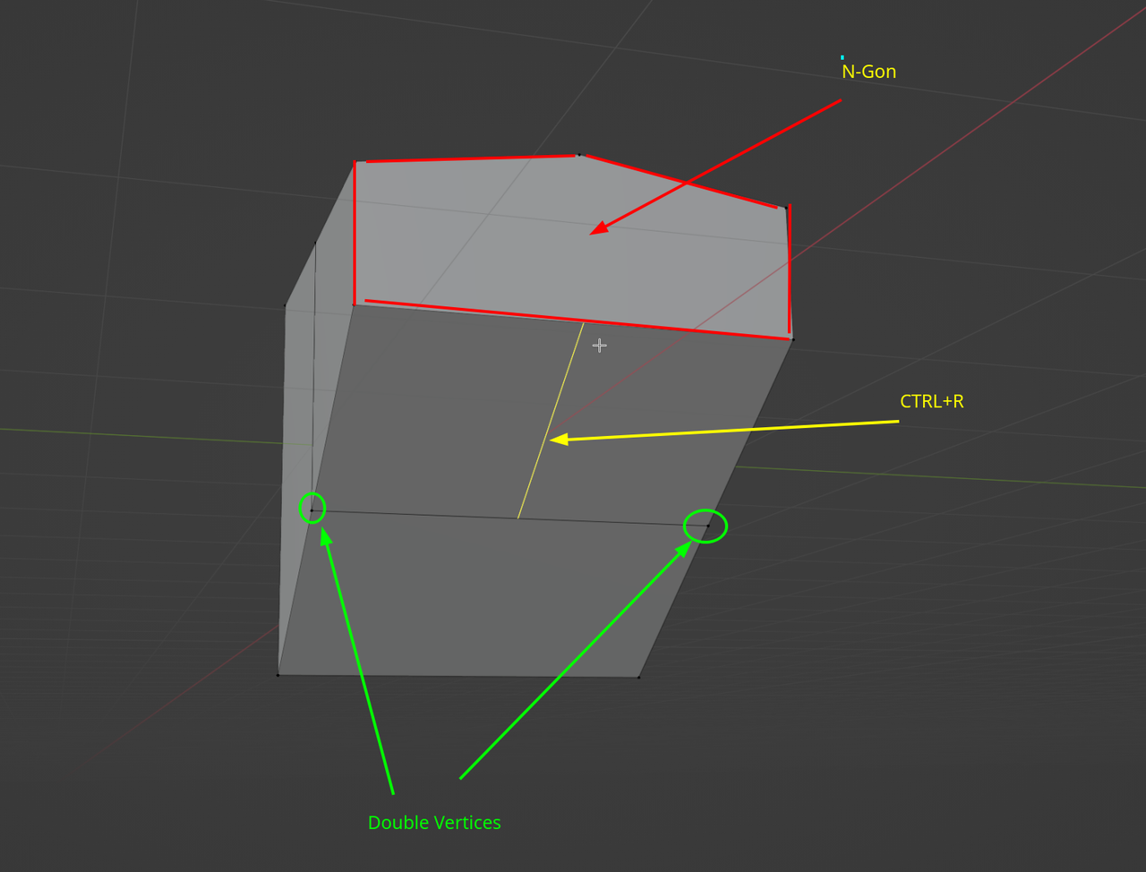

    Hi Victoria,
    CTRL+R makes an Edge Loop that crosses Quads. It’ll stop at Triangles or N-Gons (Faces with more than 4 Edges). You could also have so-called ‘double Vertices’ (two or more Vertices, at the same place in 3D space), that cause the Edge Loop to stop:
    Try selecting all (A) and the M > Merge > By Distance to get rid of ‘Double Verts’.
