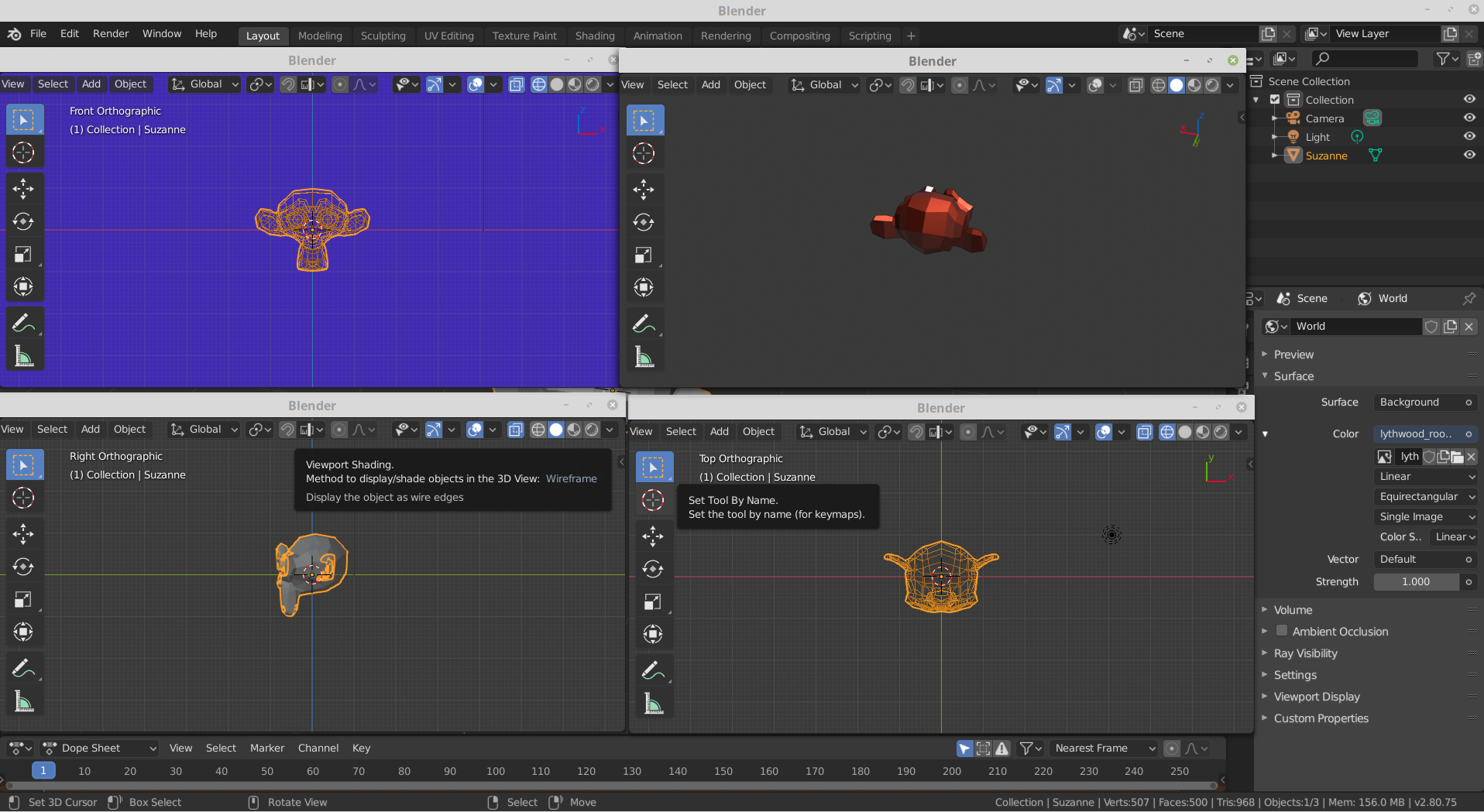

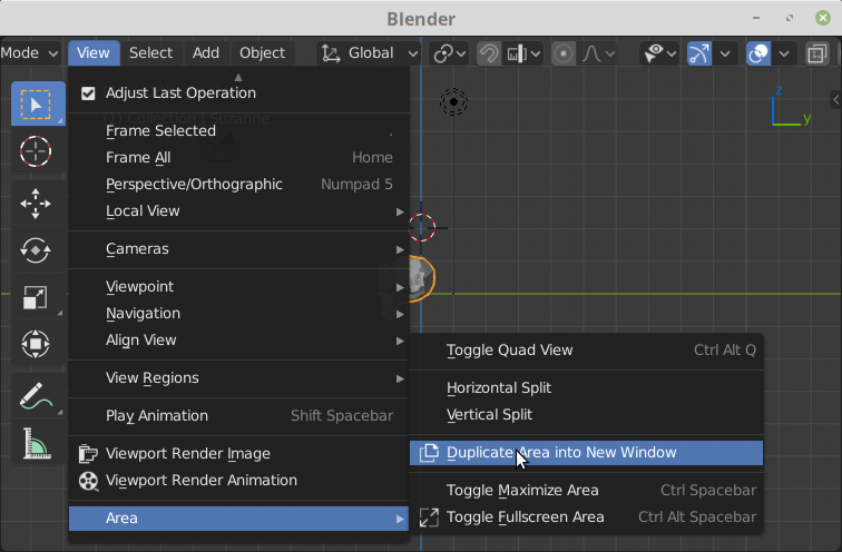

The only way to do that as far as I know is to go to View > Area > Duplicate Area into New Window:
Then you can make four new Viewports that are independent as far as shading is concerned.
Not ideal, but…
