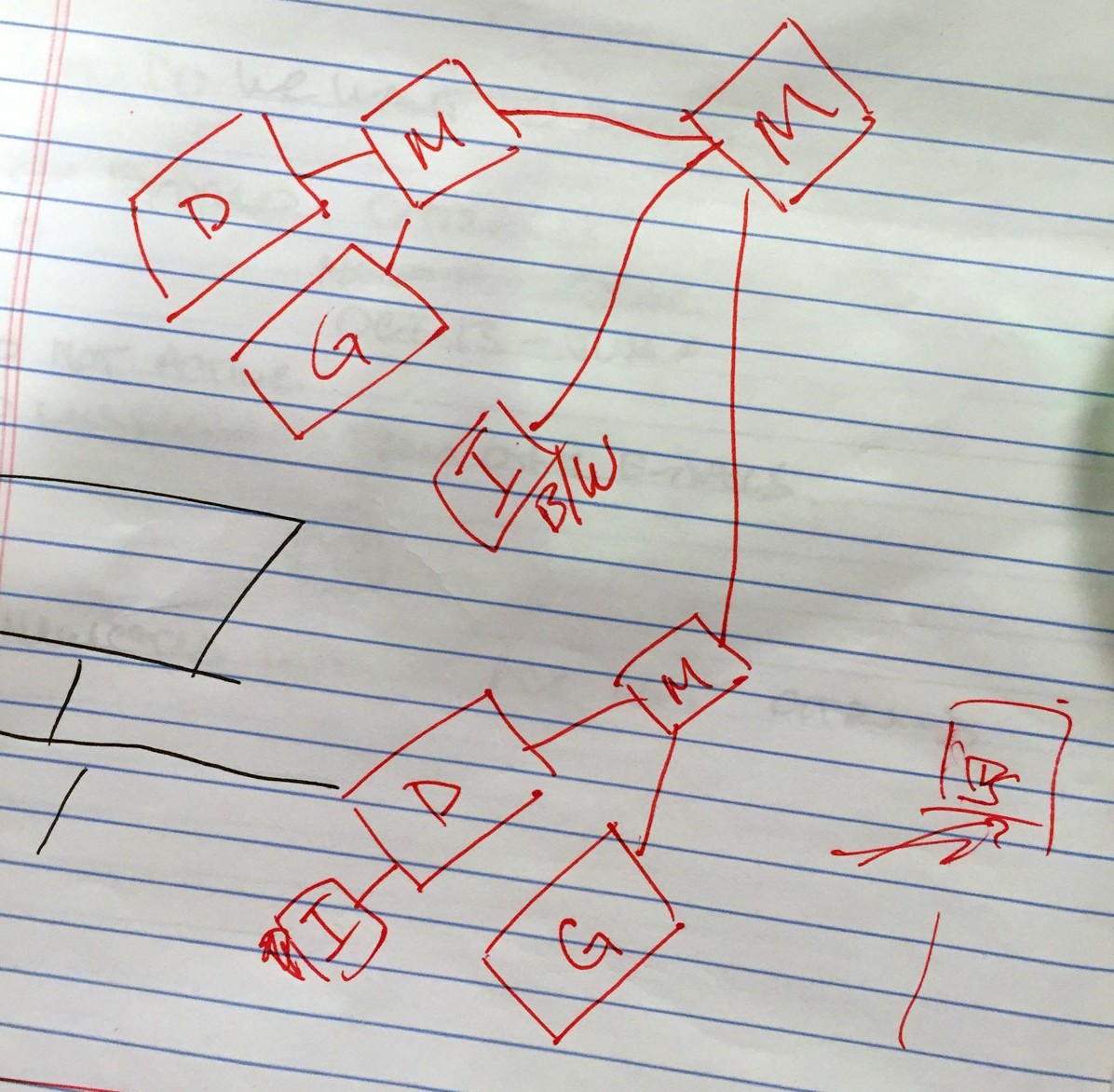

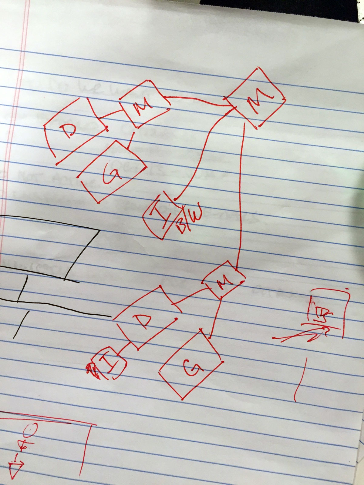

During the discussion I was asking Kent how he would layout a shader in Blender. It lead to sketching on notepads. Who can guess what type of shader this is below?

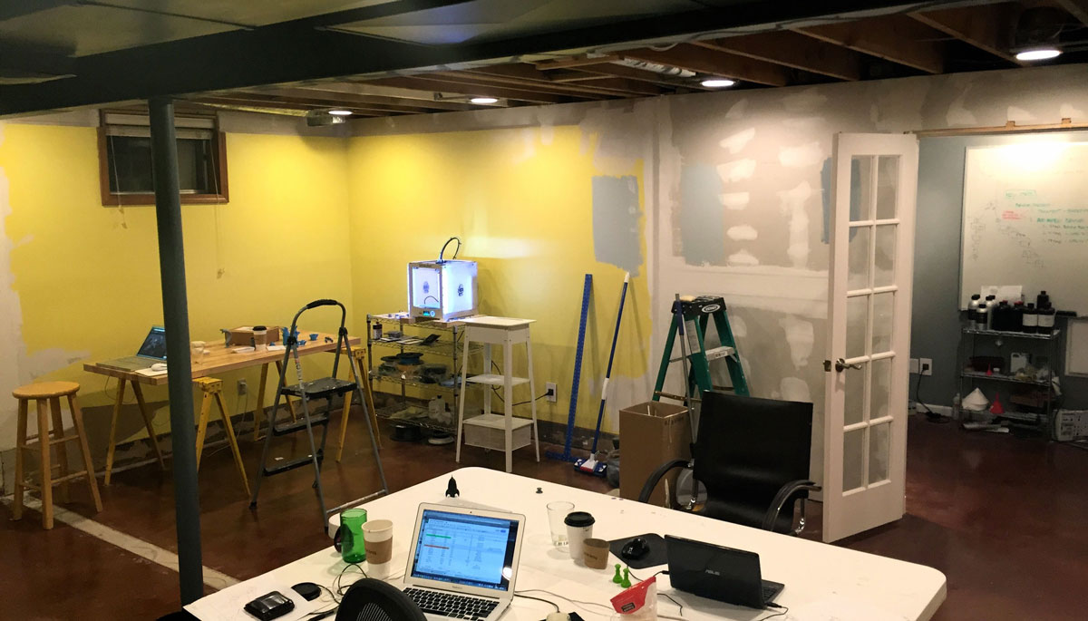

Hey guys, shall we go downstairs and print some stuff?
I tend to remember my grandparents or my parents having wood working shops in their homes, would this be the future of people having 3D printing shops in their basements?
thelap
For the next 48hrs, the room was full of eager minds asking questions, sounds of 3D printers working, and overall our personal general amazement. The sheer notion that we were creating physical objects of what we were modeling within a computer just an hour earlier is exciting.

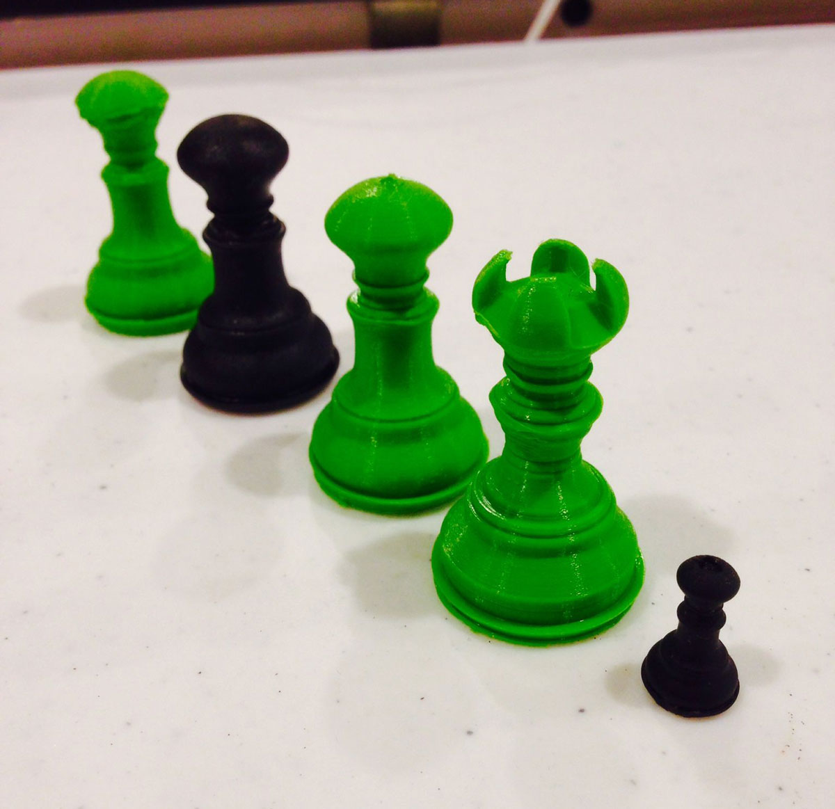

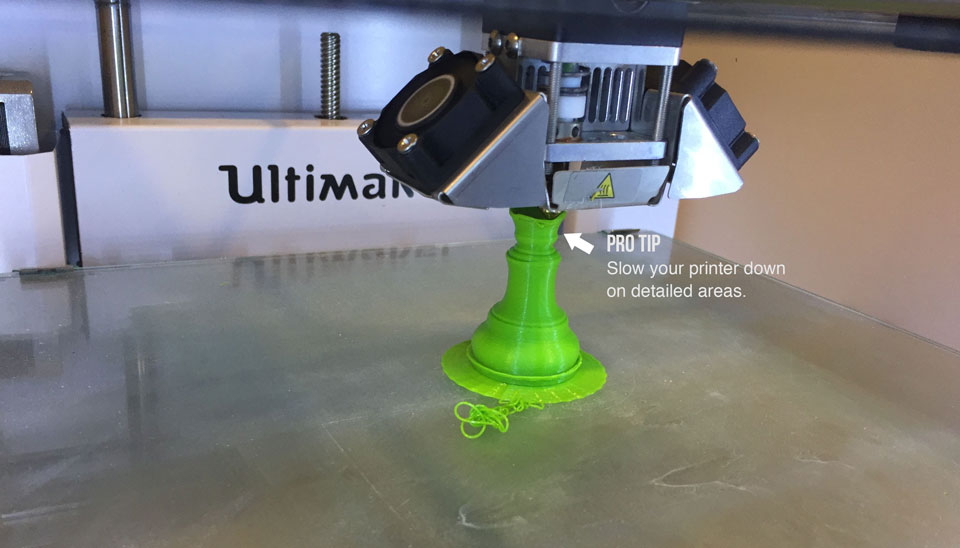

The skill or art of 3D printing is a whole other realm of information for your brain to absorb. In our case of working to print a relatively simple model of a chess piece “pawn”. We ran into several learning curves while sending it to the Ultimaker 2 an (FDM –Fused Deposition Modeling) printer,  that we simply had to go through to learn how to best print a model. With our first few tests, the top section of the pawn would begin to collapse on itself. To combat this you can slow down the printer speed specifically based on a Z value of the print head to make sure the filament has time to cure before the next layer is applied. Yay learning! 😉

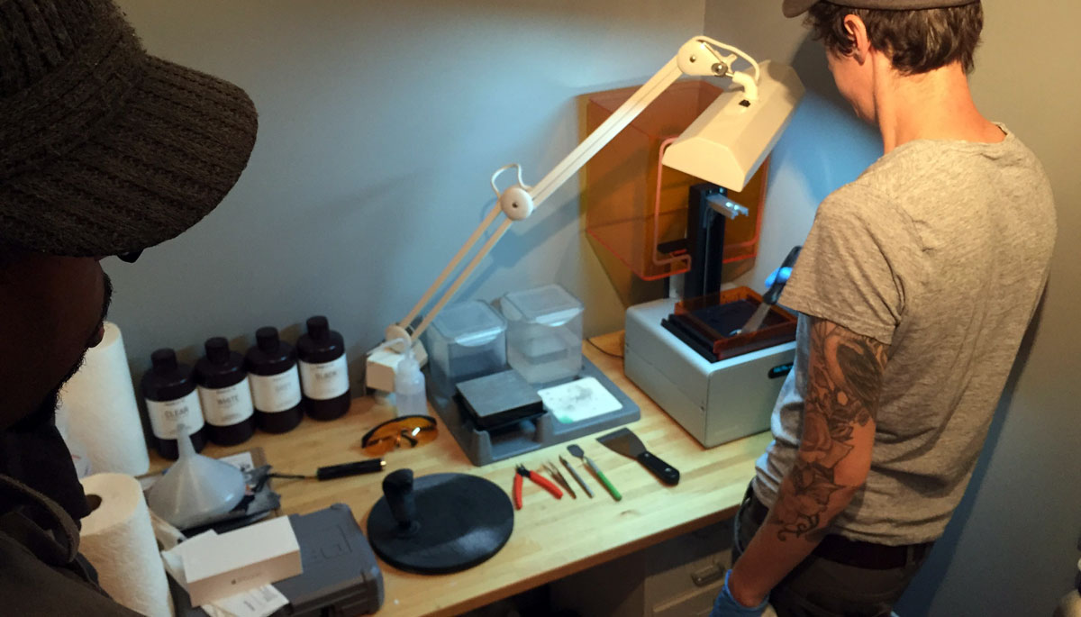

There were several other learning curves when printing with the SLA based Form 1+ printer. Being cognizant of your models angles, overhangs and supports are a factor which you must consider before hitting the print button.
