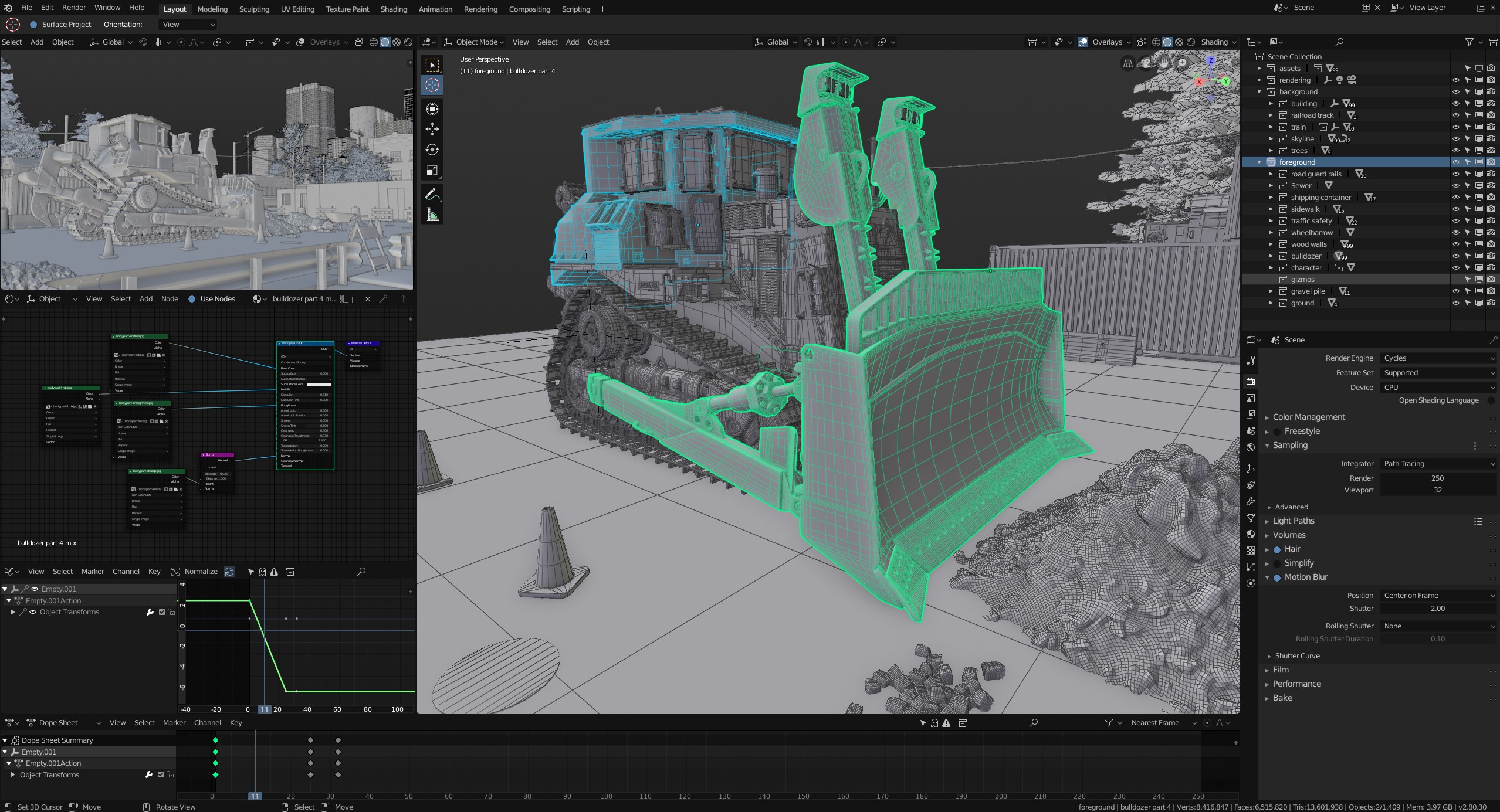

1. A Revamped User Interface
The UI in Blender will change quite a bit. It shouldn’t take very long to get used to, but old habits sometimes die hard!

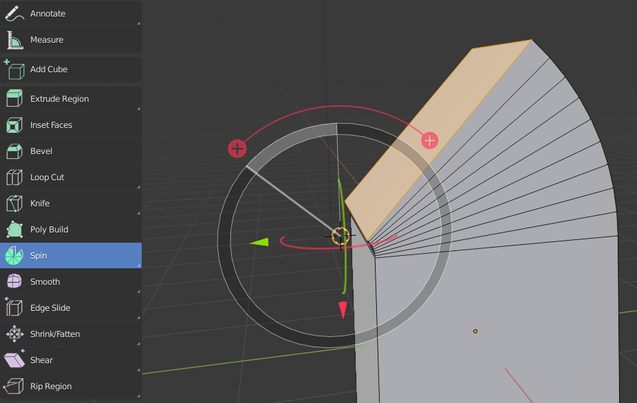

Active tools in the toolbar
Instead of an assortment of single actions, the toolbar is now home to tools with widgets! Clicking on one of these tools will make it “active”, which means it is now assigned as your left click and drag action. Most of them also have custom manipulator widgets, which make some tools much easier and more intuitive to use.
This is a welcome change for beginners since it puts Blender’s most important modeling functions front and center. For advanced users however, it will likely stay hidden since it is generally faster to just use the hotkeys and jump right into the action.

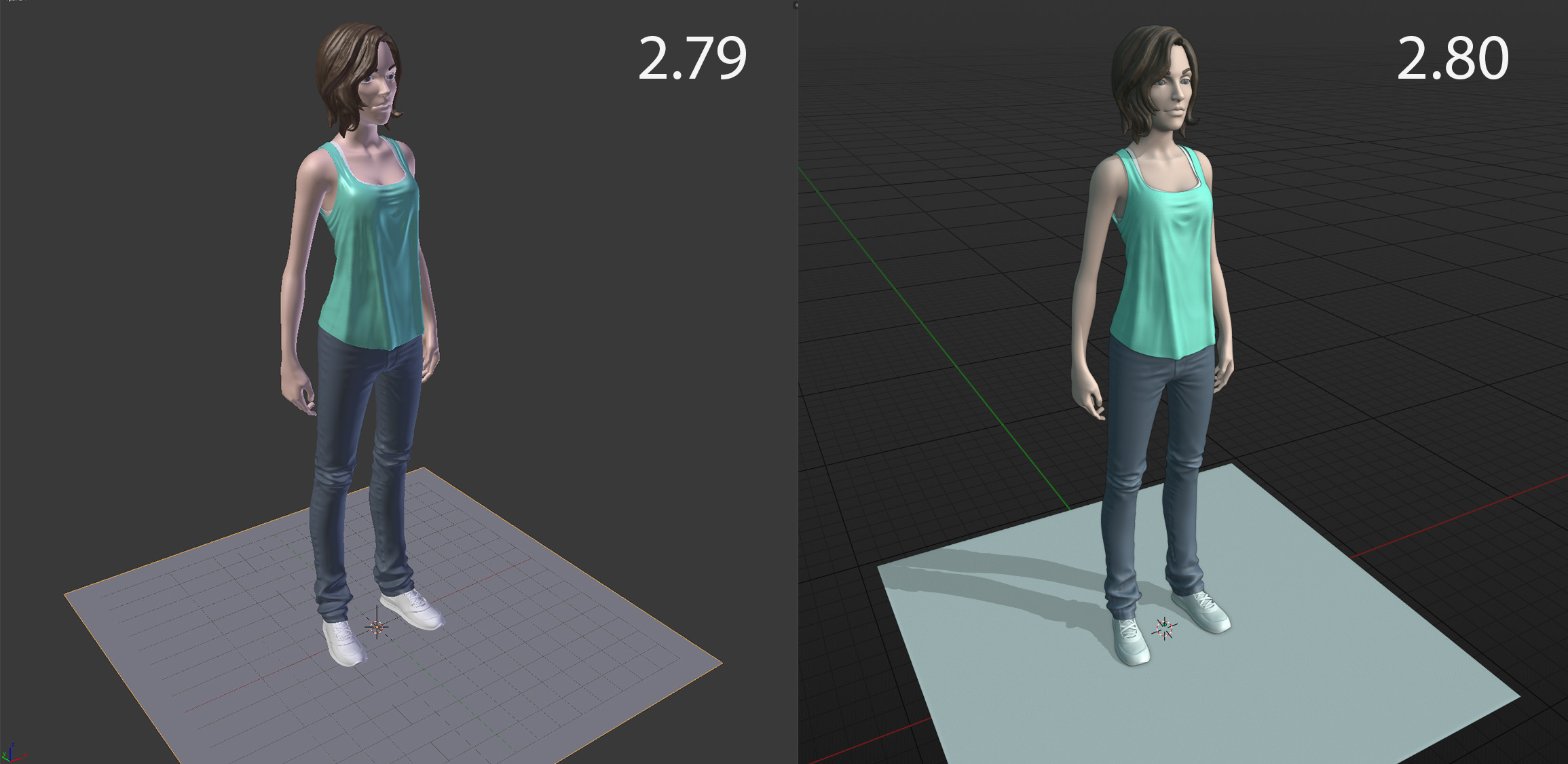

The old wire frame is no more: in Blender 2.8, Wire frames are rewritten from the ground up. They are now a part of a new overlay system, even fitting on top of EEVEE or Cycles. The wires now have Fresnel, optional colors, and a transparency effect when behind or inside other objects, all of which make it easy to see what’s going on. You can also enable wire frames on top of solid shading for all objects at once, which was a hassle to do in 2.79.

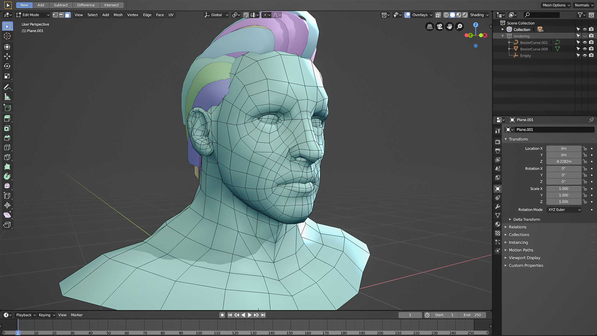

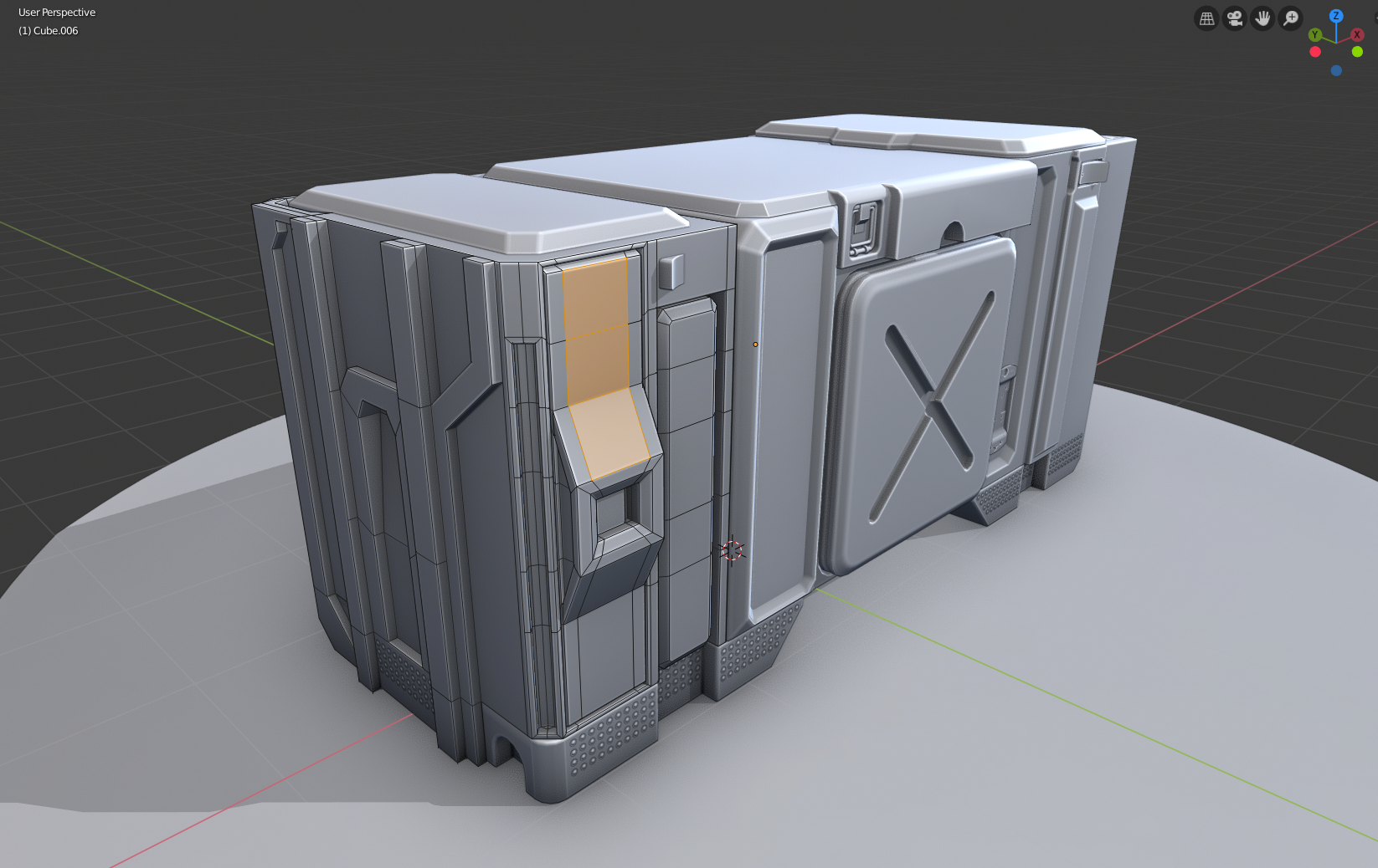

Multi-object editing
A big change that didn’t get nearly enough press is Blender 2.8’s ability to edit multiple objects at the same time. That means you can use modeling tools on groups of objects at once while still keeping them separate! In the future, you’ll likely be able to sculpt or texture paint on multiple objects at once, and editing the properties of everything you have selected will become much easier.
