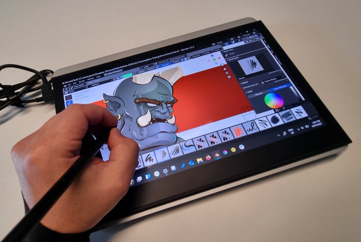

Wacom asked me to review their new Movink 13 portable pen display to see how it would perform with Blender’s Grease Pencil, so naturally I was so keen to see for myself!

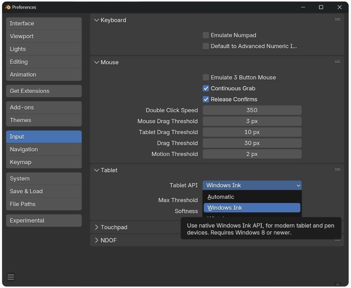

Downloading the appropriate drivers for your operating system is the obvious first step for hooking up any drawing device. If you’re on Windows, open your Blender Preferences and set your Tablet API accordingly.

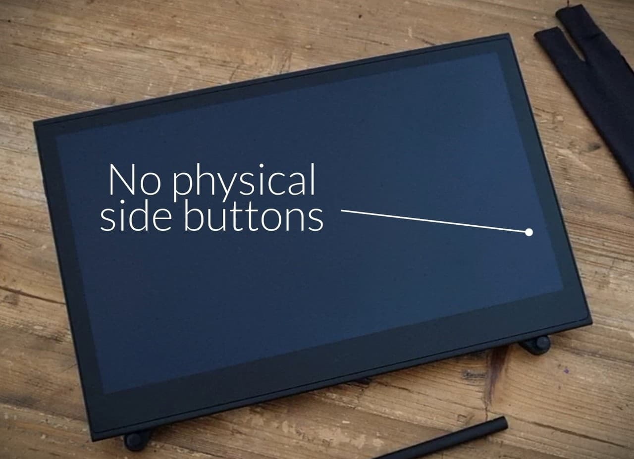

A pen display obviously means you can interact with Blender more directly, but it is not without its own unique challenges – namely physical button controls and shortcut keys – and as any seasoned Blenderhead already knows: SHORTCUT KEYS IS LIFE but the Movink is virtually button free!

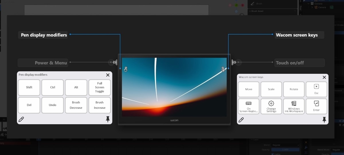

Don’t panic! If you’re familiar with other pen displays, you’ll know that the control center software allows you to customize on-screen buttons, radial menus and touch areas which allow you to have all your favorite keystrokes accessible at a glance.
This combined with the pen’s own buttons makes for a quick and intuitive workflow for drawing, and the Movink is no different.

The Movink 13 is designed for portability. It can extend the functionality of your existing laptop, or work as a comfortable pen display for your desktop. Here’s a short list of set ups I’ve experimented with:

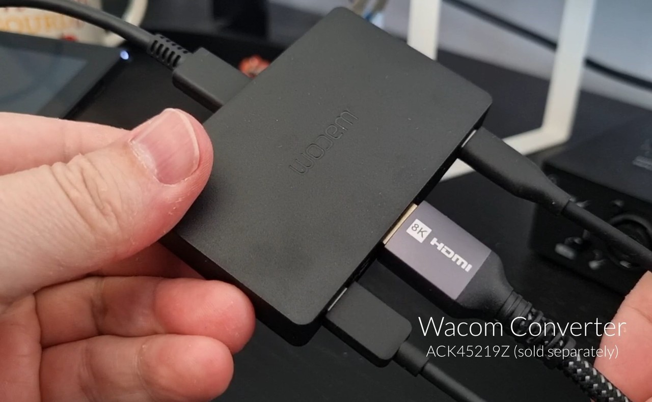

I substituted my drawing tablet with the Movink, but immediately ran into some tech issues – most importantly I discovered my PC did NOT support display over USB-C in Alt Mode!
This is a problem if your CPU does NOT have integrated Graphics. The cheapest solution (other than replacing your GPU with a USB-C display port output, or Upgrade your CPU to something with onboard Graphics) is to grab a converter that can take power, USB and HDMI signals and combine them so that your Movink will receive and respond correctly.

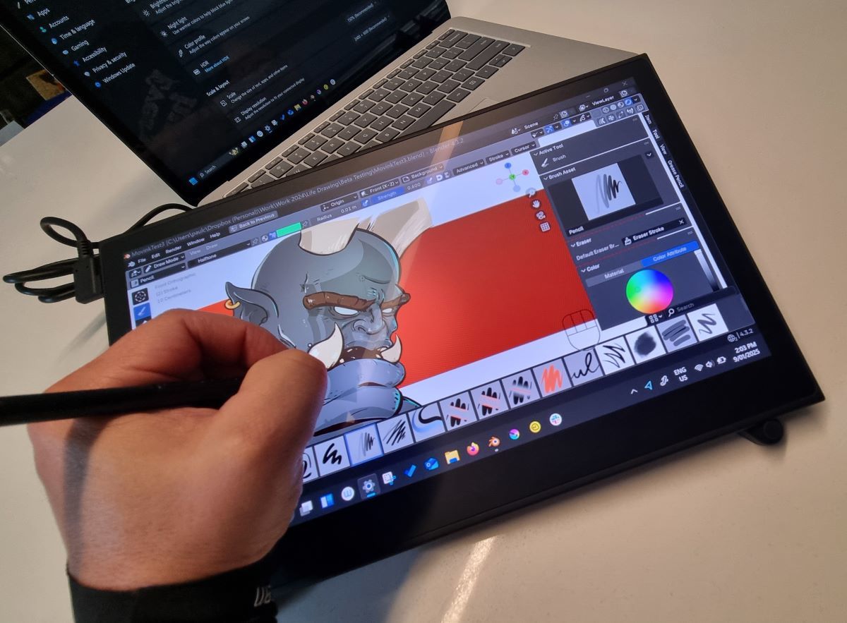

Option A: Standard Laptop Setup
Most laptops and macbooks released in the last few years *should* have a USB-C or at least a USB port that can be switched to Alt-Mode, so you’ll be able to connect your Movink 13 via a single cable and use it as an external display – mirrored or extended.
My preference is Extended, and to set the Movink as your Primary Display when attached. This will minimize troubleshooting for overlays and touch settings.
Movink 13 and Open Laptop
I use an optional stand as well, but this allows me to work freely, AND use my Laptop screen as a 2nd monitor ideal for references, or to look at work applications while you draw.

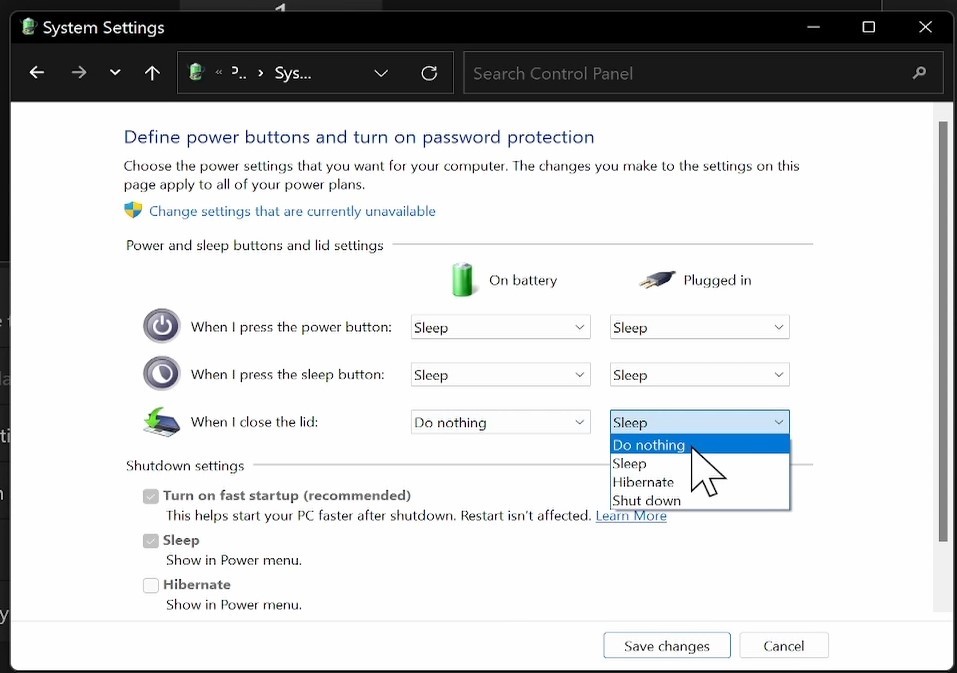

If I’m in transit, or in a situation where having my laptop open is not ideal, I set my laptop’s power settings so that it does not go into sleep mode when it is closed.
Laptop Battery Settings for Movink 13
Now I can carry my laptop in my backpack, or use it as a table for the Movink and sketch as if I were on a portable touch device.

The Movink shares similar customization settings with other pen displays such as the Cintiq and you can lay these out in all manner of ways that suit your own purposes.
This is my essential set mapped to the two side areas on the bevel:
Movink custom shortcut settings

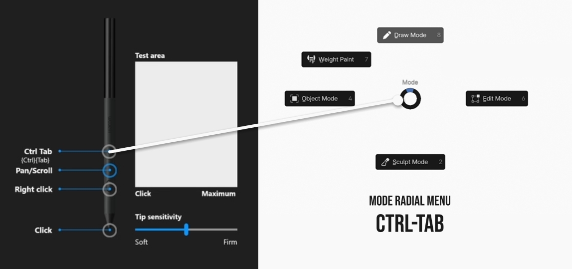

The Pen buttons are also mapped for essential use:
  • Top Button: CTRL-TAB
  • Middle Button: Middle-Mouse Click
  • Bottom Button: Right Mouse Click (default)
Movink Custom Blender Grease Pencil Pen Settings

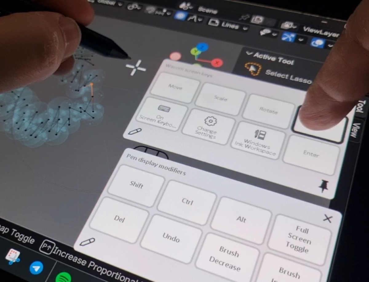

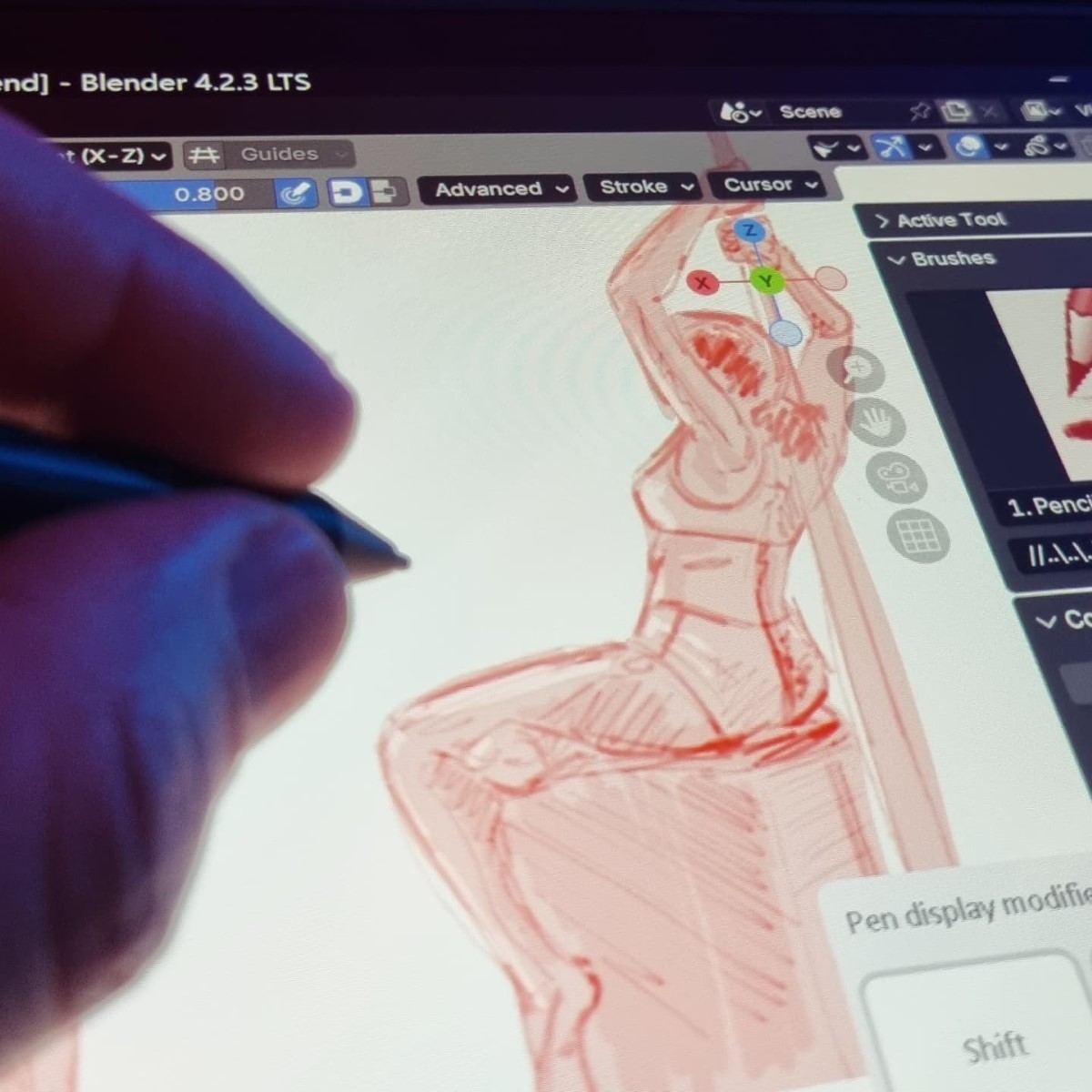

I now have a range of options to toggle modes, move, zoom increase/decrease brush sizes, even switch between draw and erase, but using a combination of mouse functions mapped to the pen, and modifier keys via my Pen Display Modifiers grid.
Wacom Movink 13 Touch Screen

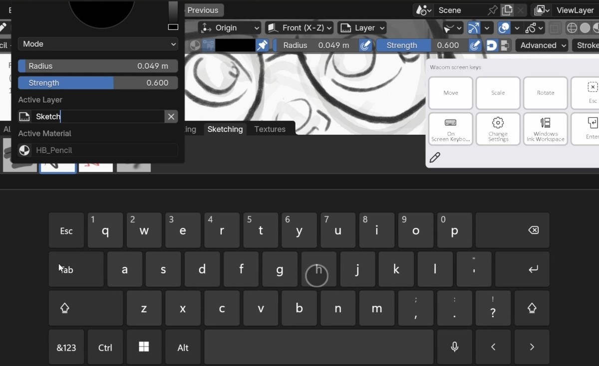

No keyboard is required – but even if one is (for, say, labeling layers), I’ve retained the On Screen Keyboard toggle in my Wacom Screen Keys.
On-screen Keyboard
