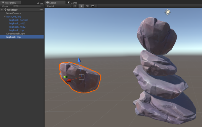

I prefer using FBX files as it allows me to keep the same hierarchy of objects (child meshes) in one complete package. This is important if you’re working with a mesh that has moving parts and/or needs specific parts that can be separated in game. Take a look at this rock exported from Blender:
RockFBX
Note the entire group can be used as one bigger prop, but we can also utilize the individual pieces of that same group for singular rocks. This is one of the big advantages of using an FBX file type. Another is that FBX can support animations. You can export out a rigged character with animations as an FBX file.

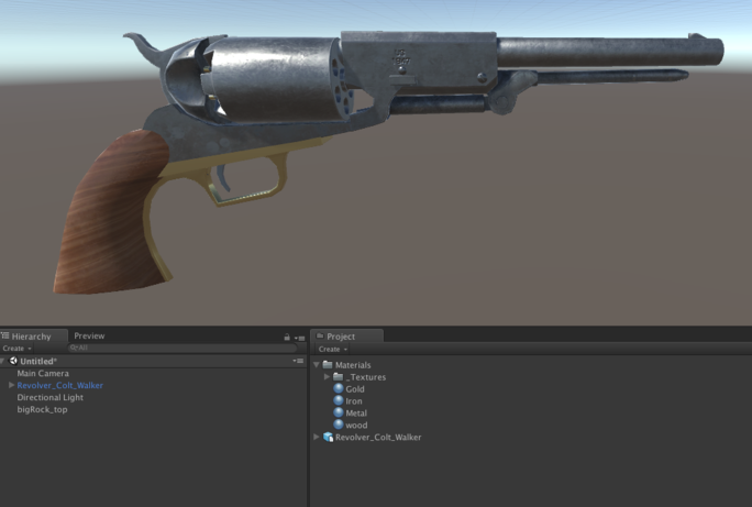

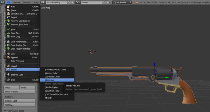

For the sake of simplicity we’ll utilize the revolver shown in the above screenshots. This contains multiple pieces that can be animated in game and if you’re curious of how this is done you can check out the Colt Walker Revolver resource: https://cgcookie.com/resource/colt-walker-revolver/. In Blender we want to ensure that our meshes have appropriately named materials and meshes. This is often overlooked and can cause frustration later on when you’re trying to locate specific materials or meshes within Unity. This is also a great time to notice if any meshes are missing materials and/or if any meshes need to be combined. I prefer to keep meshes separate only if they will be moving, otherwise I combine them with bigger pieces.
MeshMaterial

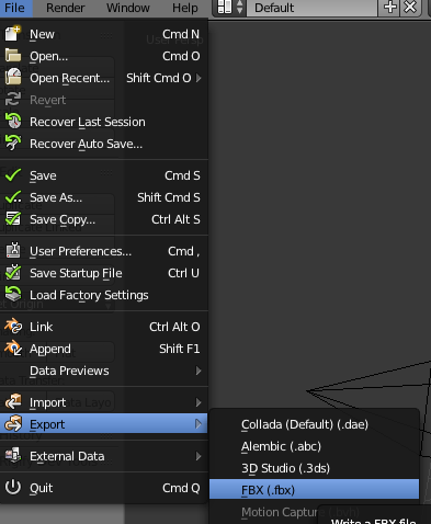

For this particular model there are a variety of meshes on different layers, so I want to select everything within the current view then go to File > Export > FBX
ExportingFBX
When you click on FBX you’ll see a new window pop up with a place to save this FBX, but before you click on anything else you want to ensure you have the proper settings enabled. Since I only want to export what I have selected I have Selected Objects enabled.
SelectedMesh
*Note this is not always going to be the case. If you only have one object and one layer you don’t need to check this.
I also have only Mesh selected to export. I don’t need to export any empty, camera, lamp or other objects. Once you have all that selected you can then name the FBX what you want and click on export. Great now you have a FBX file ready to be imported into Unity.

With Unity open you want to drag and drop this file into the project panel. When you do that it should import into your project and it will create a materials folder with the names of the materials of that mesh:
  ImportedFBX

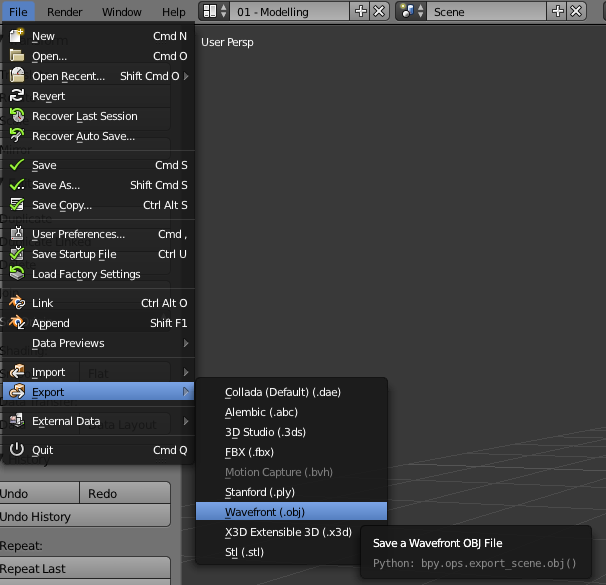

The process for exporting an OBJ is going to be nearly identical so we won’t repeat steps. Go to File>Export>Wavefront OBJ. The settings for OBJ are going to be quite different, but in this case we don’t need to worry about changing anything.
*Note for this object I wanted to export meshes from a specific layer so I have “Selection Only” enabled here just like the FBX process.
OBJSettings

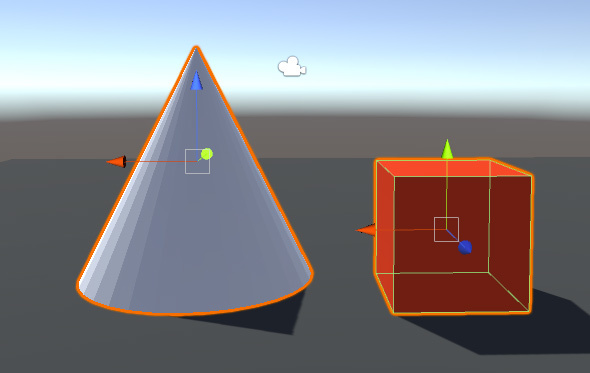

Unity and Blender utilize different coordinate systems. Blender uses the Z axis upward while Unity uses the Y axis. While Unity does tend to do a good job of converting this there may be times when this just won’t work properly. If need be you can rotate it in Blender and/or try the export settings. You can also utilize an empty game object as a parent in Unity to get the proper orientation.
  Cone
Up above is a cone exported from Blender which as you can see has the Z axis pointing up while the red Unity cube has the Y axis pointing up. There is a relatively quick fix for this in Blender which is still “experimental” as the name implies.
On Export check the !Experimental! Apply Transform checkbox.
ApplyTransform
This will now orientate the cone to the proper orientation for Unity:
  ConeY
