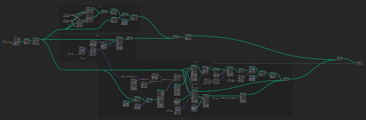

Geometry Nodes
Performance was a big focus for this release. Several nodes got large speedups including many of the curve and utility nodes.
A Duplicate Elements node was added, which instances geometry a dynamic number of times.
The new Face is Planar node returns whether or not the triangles of a face are lying flat.
The Merge by Distance node now has a new option to only evaluate vertices that are connected, which can be significantly faster.
A Geometry Nodes node group attribute name inputs can now have a default value for if you want to assume that each object has an attribute of the same name, such as ‘UVMap’.
Speaking of attributes, named attributes are back in action! They can be stored, removed, and input via their respective new nodes. The Geometry Nodes modifier also has a new section, called Internal Dependencies, which lists all of the named attributes that are used in the node tree.
Lastly, the legacy nodes that predated the fields system have been removed, so those files will not be compatible with Blender 3.2 and above.

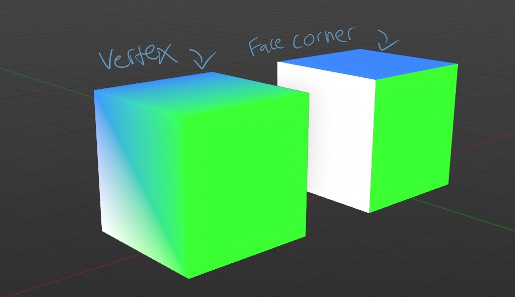

Vertex Colors have been refactored and renamed as Color Attributes. The big benefit of the update is that they can now be stored on face corners instead of just vertices, which allows you to paint individual faces separate colors.

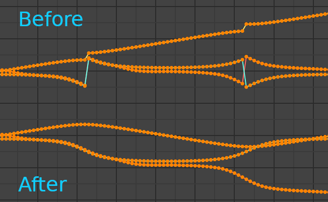

The Graph Editor’s Discontinuity (Euler) Filter, which is great for cleaning up jumps in equivalent values (such as a jump between 0 and 360 degrees in rotation), can now be used in the Dope Sheet as well.

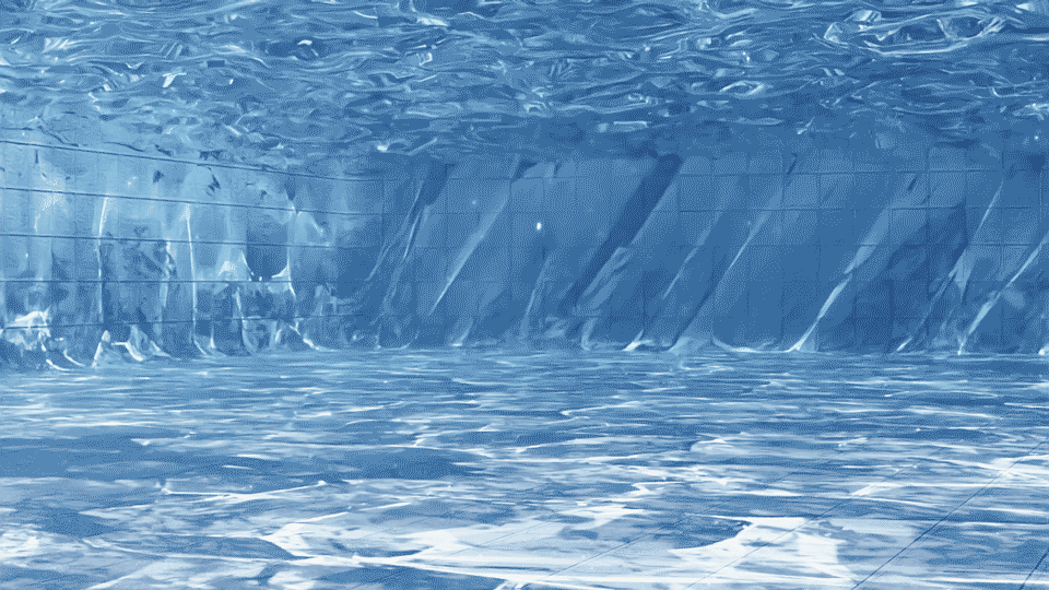

Cycles can now render faster caustics! Well, in some situations. The improvement is only for refractive caustics that happen to be inside of a shadow and from a mesh that is smooth shaded. Bump and normal maps are ignored in the calculation and they don’t work on Metal GPUs. To use these shadow caustics, you need to enable them for the casting and the receiving objects in the Object Properties as well as for the light in the Light Data properties. The effect seems to be pretty dependent on the amount of geometry, so you may need to play around with different detail levels to get the effect that you’re after.

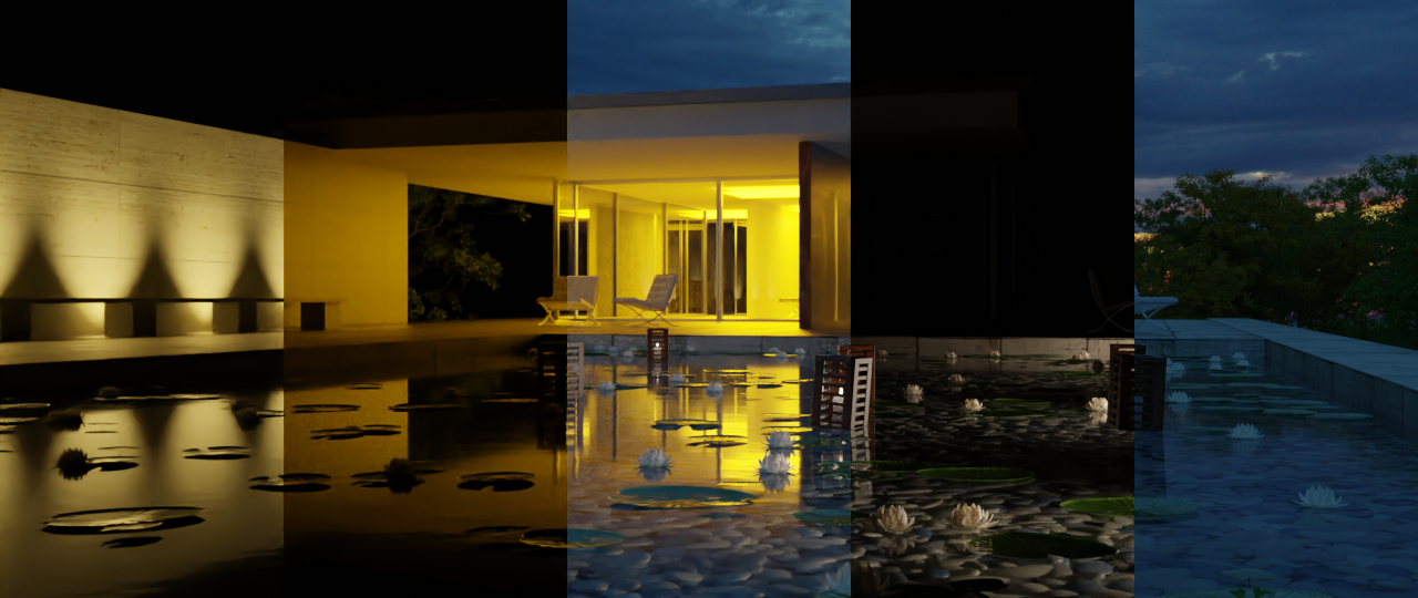

Light Groups (not to be confused with the long awaited Light Linking) have been added to Cycles in the View Layer tab, and you can use it to separately adjust each light’s influence in the compositor after rendering.

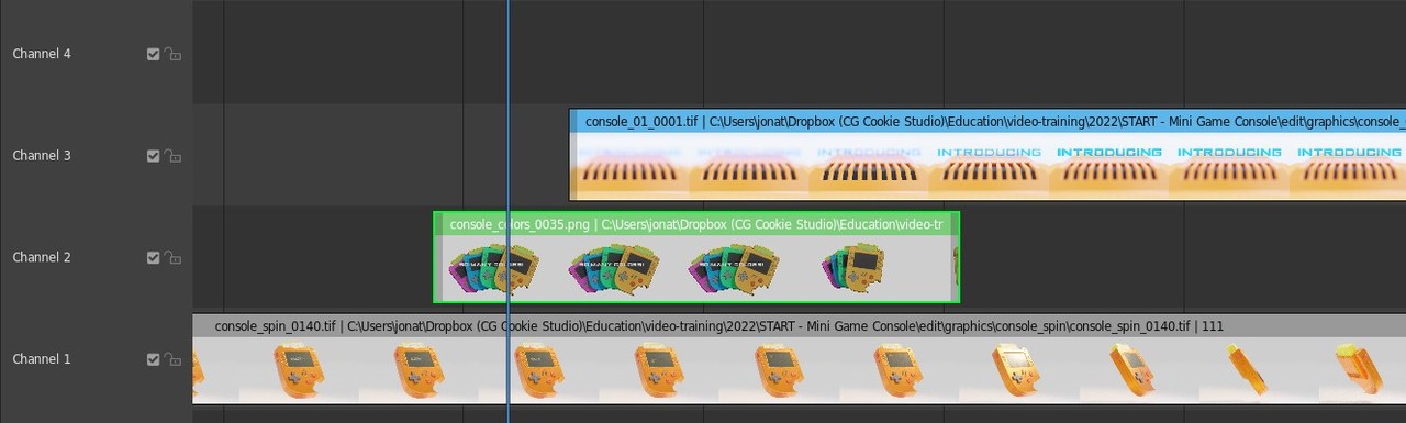

The Video Sequence Editor continues its slow but steady improvement in Blender 3.2. The most obvious change are the new channel headers, where you can rename, mute, or lock each channel. You can now optionally create a new scene via scene strips, the transform tools are much more reliable, a strip’s thumbnail (which can be enabled in the overlays menu) is now updated when you move its handle, and a new Limit View to Contents checkbox is enabled by default which locks the height and scrolling to only the used channels.
