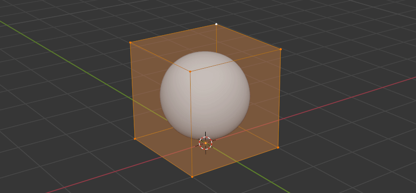

The View pie menu, with the always handy Frame Selected and Frame All shortcuts, has been added to the Node, Video Sequence, Dope Sheet, Graph, NLA, Image, Clip, and Outliner Editors.

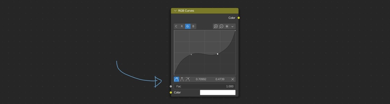

Curve widgets
, like the one on the RGB Curves node, now allow you to change the curve handle type when you select a point.

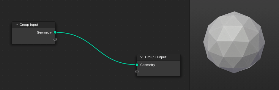

Geometry Nodes

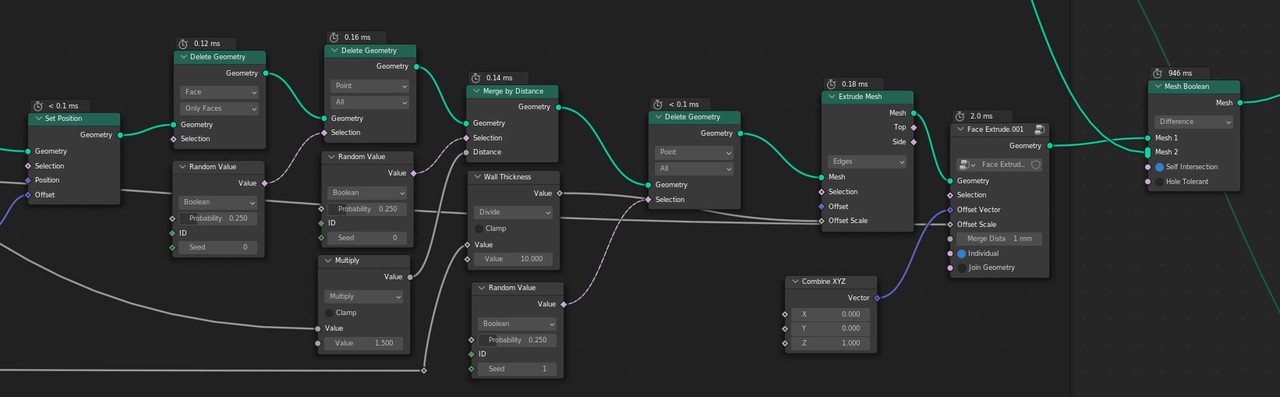

The biggest area of visible improvement in Blender 3.1 is in Geometry Nodes. While there are a lot of new nodes (19 to be exact), the most important jump in my opinion is in performance. The list of improvements is too long to list here, but the evaluation of several nodes, including crucial ones like Set Position and Realize Instances, was sped up 2-6x and in some cases multithreaded.
A new overlay option, Timings, shows how long each node takes to calculate so you can more easily figure out what part of the graph you need to optimize.

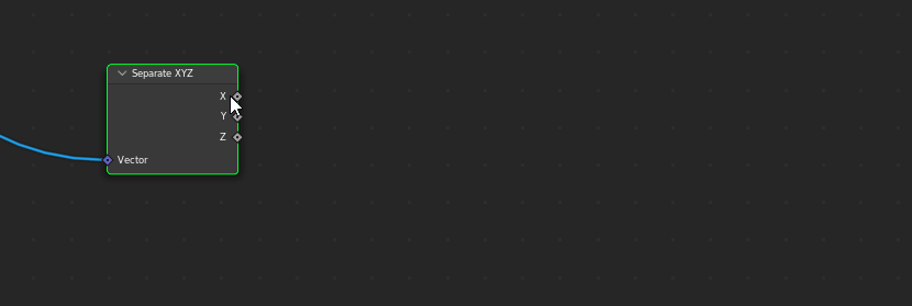

When dragging a node input or output link over empty space, a new search menu allows quickly connecting any node with a compatible socket.

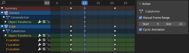

Actions can now have a custom frame range, which can be set in the sidebar of the Action Editor, Dope Sheet, and NLA Editor. This is similar to setting an action’s NLA strip length manually but is more convenient. The new Cyclic Animation toggle below the frame range options does not actually cycle the animation, but it does tell Cycle-Aware Keying which frames to use as the start and end frames, which should make it easier to use.

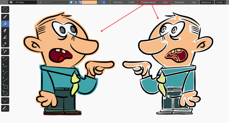

The Fill tool has a new Dilate option, which can either be used to over-flood an area or leave a gap between the fill and the stroke.

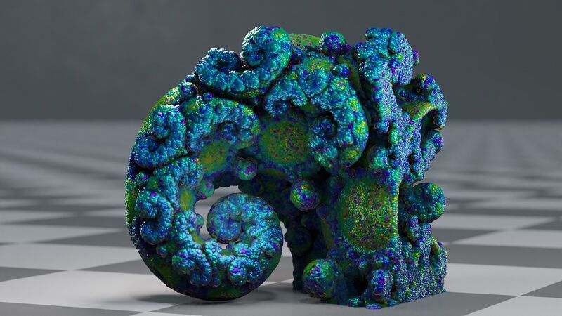

Cycles can now render point clouds! This is extremely exciting since it allows you to render particles directly and efficiently without having to instance spheres. A new Point Info node in the shader editor lets you get data about each point, such as their size, to use in your shaders. The downside is that it only works with particles imported from other software for some reason, and with points generated with Geometry Nodes.

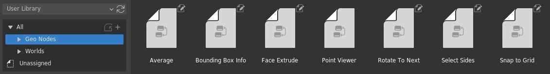

The Asset Browser now supports node groups! Time to finally save my custom procedural textures where I can actually find them for later.
