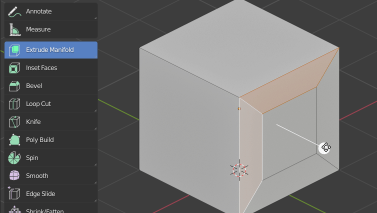

Extrude Manifold is a new tool for extruding faces inwards while deleting overlapping faces and dissolving overlapping vertices. You can’t use it to punch holes straight through objects yet, but its initial implementation is already very useful.

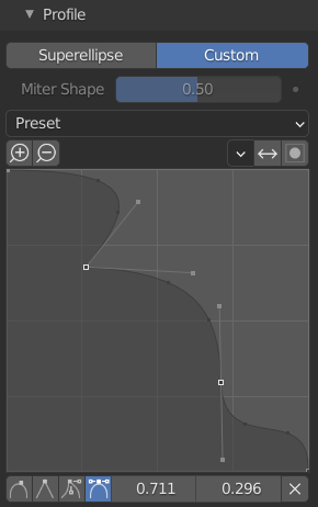

The Bevel Modifier’s custom profile curve can now be controlled with Bezier handles.  It also has a new Width Type called Absolute, which lets you specify the exact distance along the edges of the bevel. That often results in bevels of uneven width when two connected edges are at different angles, but it may be helpful in some circumstances when Offset or Width doesn’t cut it.

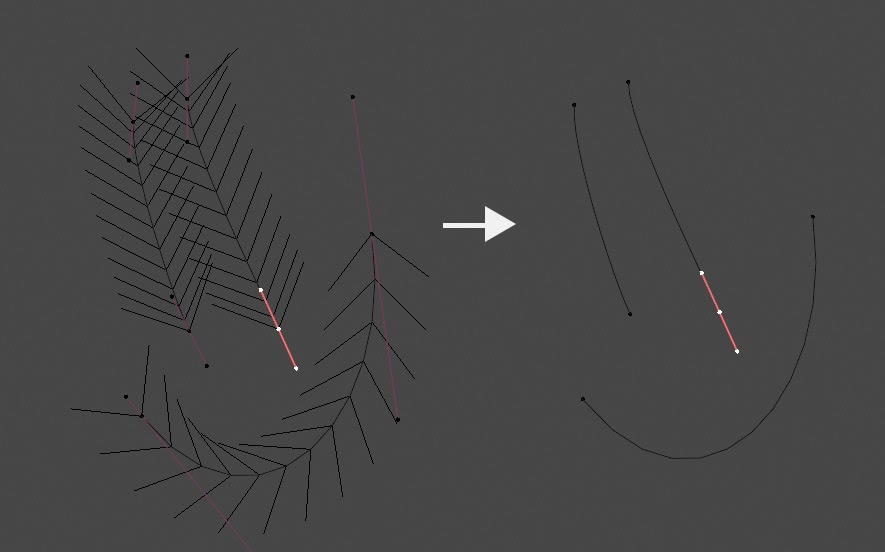

Curve editing has a few changes as well. If you reset your settings, viewing the normals is disabled by default in the Overlays popover. This is great for getting rid of clutter in the viewport but makes it less obvious which direction the curve is going. There is also an option to display only the handles for selected points, similar to Illustrator and other vector software.

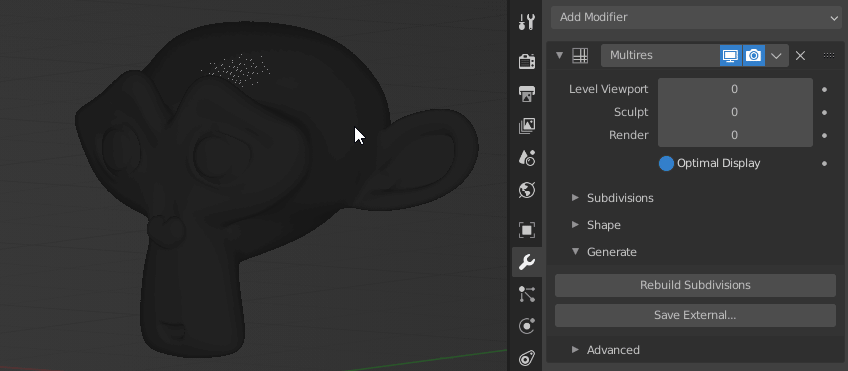

The updated Multires modifier can also now Rebuild Subdivisions, which can be used to take a high res ZBrush sculpt export (for example) and recreate each subdiv level so that the low poly base is now editable and it works with the modifier. Alternatively, you can choose Save External to bake out the high resolution details as a texture.

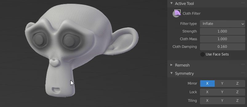

The Cloth Brush has spawned off a second tool called the Cloth Filter, which simulates the entire mesh at once. It’s much too fun to mess with!

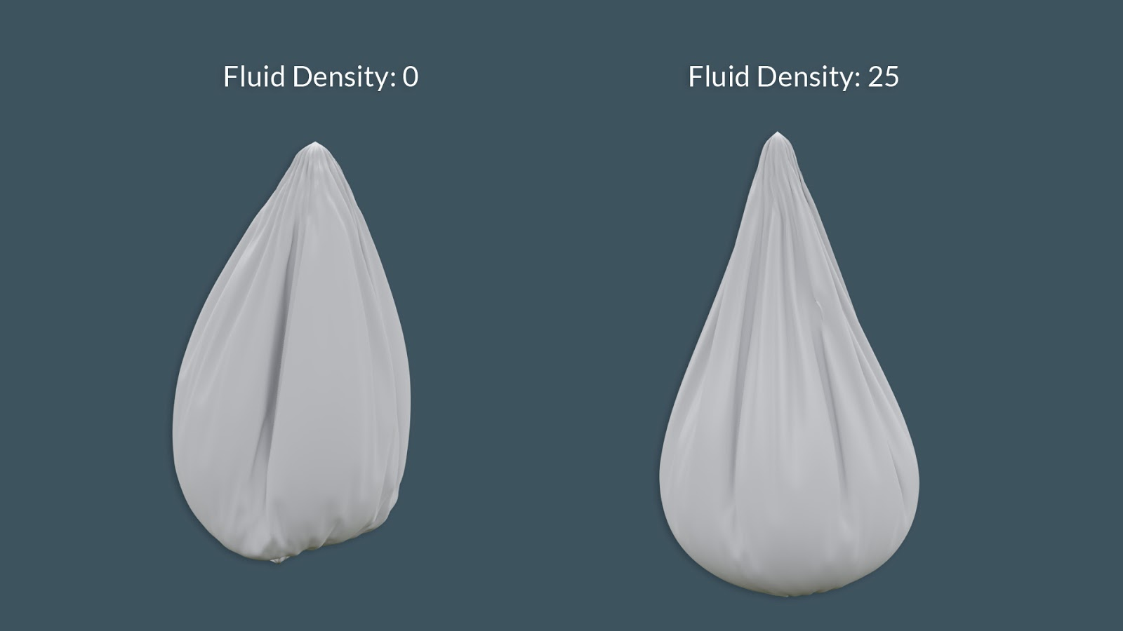

The Cloth simulator has a new Fluid Density pressure option, which adds gravity to the simulated pressure. If you’ve always wanted to simulate a bag full of water – now you can!

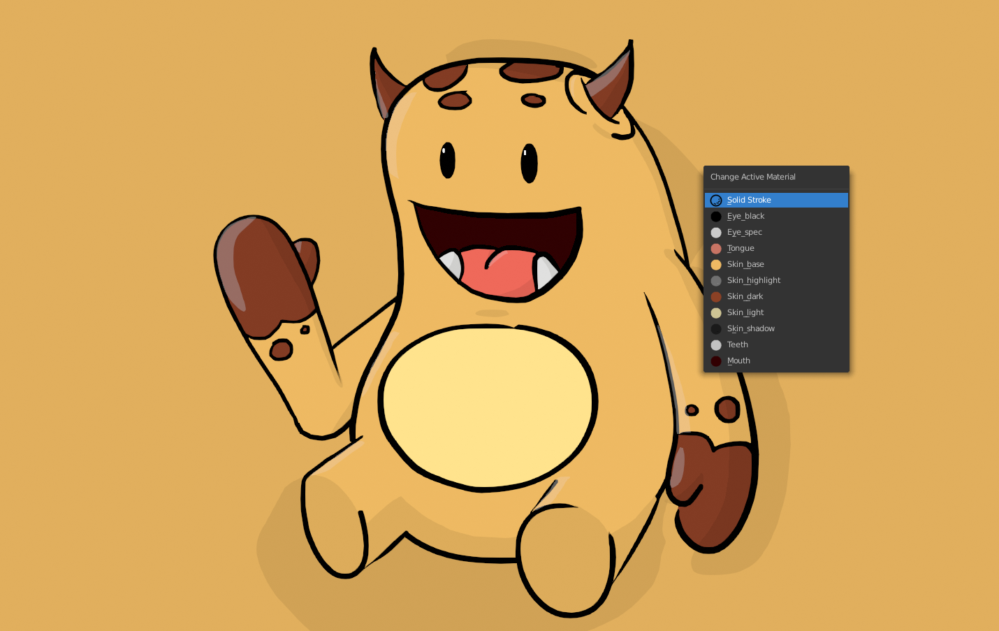

You can now quickly switch between Grease Pencil active materials while drawing, with the hotkey U, or with the new dropdown menu in the right click context menu.

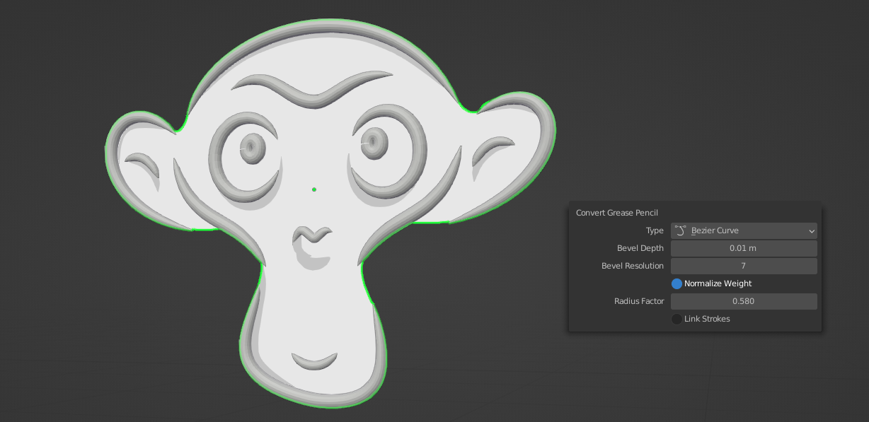

Converting Grease Pencil objects to Curve objects now has Bevel options so that you can really quickly make 3D shapes out of your drawings.

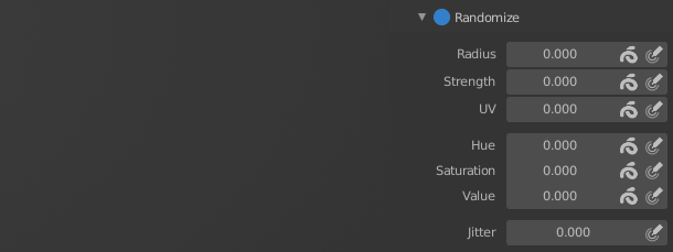

The new Randomize options in the Brush Settings are also fun to mess with. Those might help your drawings look a little more messy (hopefully in a cool way)!

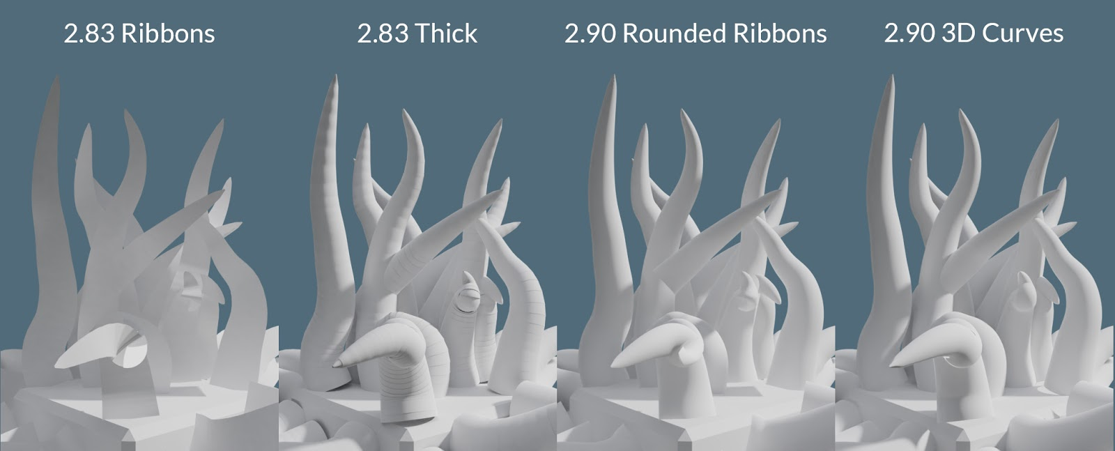

The switch to Embree also changes how hair is converted to geometry for rendering. For both CPU and GPU rendering, hair can either be Rounded Ribbons or 3D Curves.

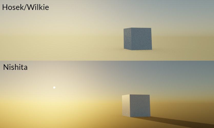

There’s a cool new Sky Texture type, Nishita, that is a bit more physically accurate than the previous sky models since it takes into account altitude and ozone absorption, plus it actually shows a sun which can cast shadows. It’s also much easier to control since it uses input values for elevation and rotation rather than the finicky normal ball thing. Nishita only works in Cycles at the moment.

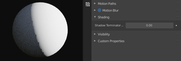

There’s a nasty path tracing artifact that you’ll see if you set a lower poly object to be flat shaded and give it a sharp falloff of light. It’s plagued Blender and other renderers like Cycles for quite a while, but no longer! You can now set a Shadow Terminator Offset in the object properties to shift the shadow and cover over any jagged edges.

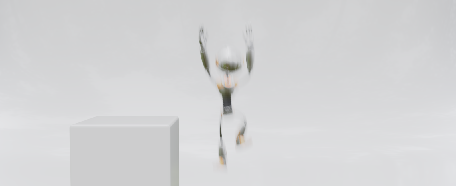

Eevee motion blur has been completely redesigned and now works with object, deformation, and even hair movement.

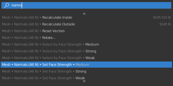

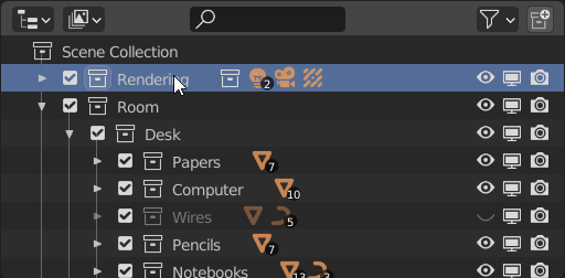

Blender’s F3 operator search box now works a little bit differently in that it searches through all available menu items for the mode that you’re in.
This helps to give more relevant results. It also allows the search to display where you can find each command in the menus as well as the hotkey for the menu and the hotkey for the specific command. You can also now right click and add any search result to your quick favorites (Q) menu!
Modifiers and constraints can now be dragged and dropped to reorder! To speed things up even more, hotkeys can now be used while the mouse is hovering over the modifier to apply (CTRL+A), duplicate (Shift+D), and delete (X).

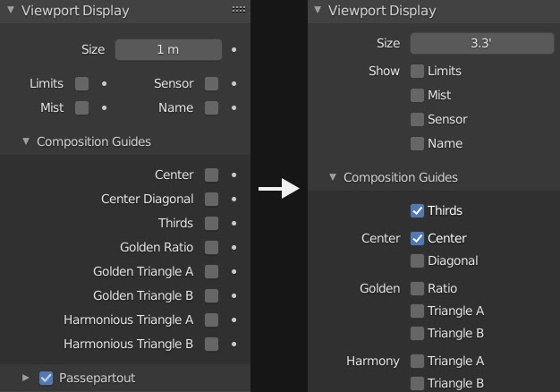

Checkboxes have been updated so that they’re centered and have labels that more clearly describe what they are for. In some places it makes the lists longer and in some areas it makes them shorter. Overall, it’s more consistent and aligned with the rest of the UI!
Shader node input sockets are now shown in the UI with the correct color and have moved to the left side to match the node in the shader editor.

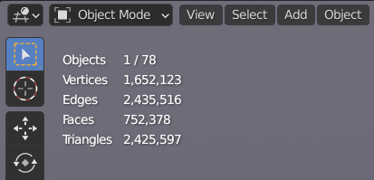

Scene statistics can now be displayed in the 3D Viewport if you enable them in the Overlays popover. They’ve moved out of the Status Bar by default, but you can enable them again in the Status Bar by right clicking (near the version number) and choosing Scene Statistic.

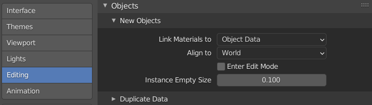

There’s a new setting in the Preferences to change the default size of the empty which shows the center point of collection instances. Hooray, I can set it to (almost) zero!
Text input boxes now have their own undo stack while you’re typing. That means less trying-to-fix-a-typo-but-accidentally-erased-progress situations!
Deleting stuff in the Outliner now works predictably and deletes anything you have selected.
Plus, dragging things in the outliner now scrolls when you reach an edge. Same goes for any other drag and drop elements (like modifiers) in Blender. Slick!
