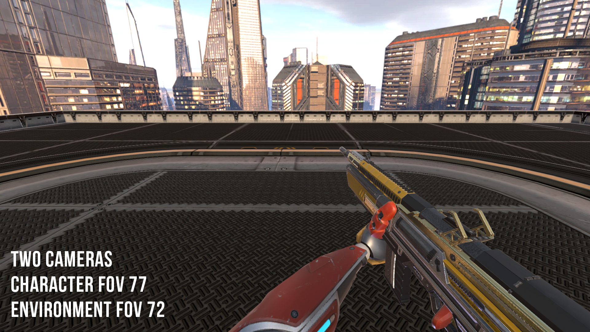

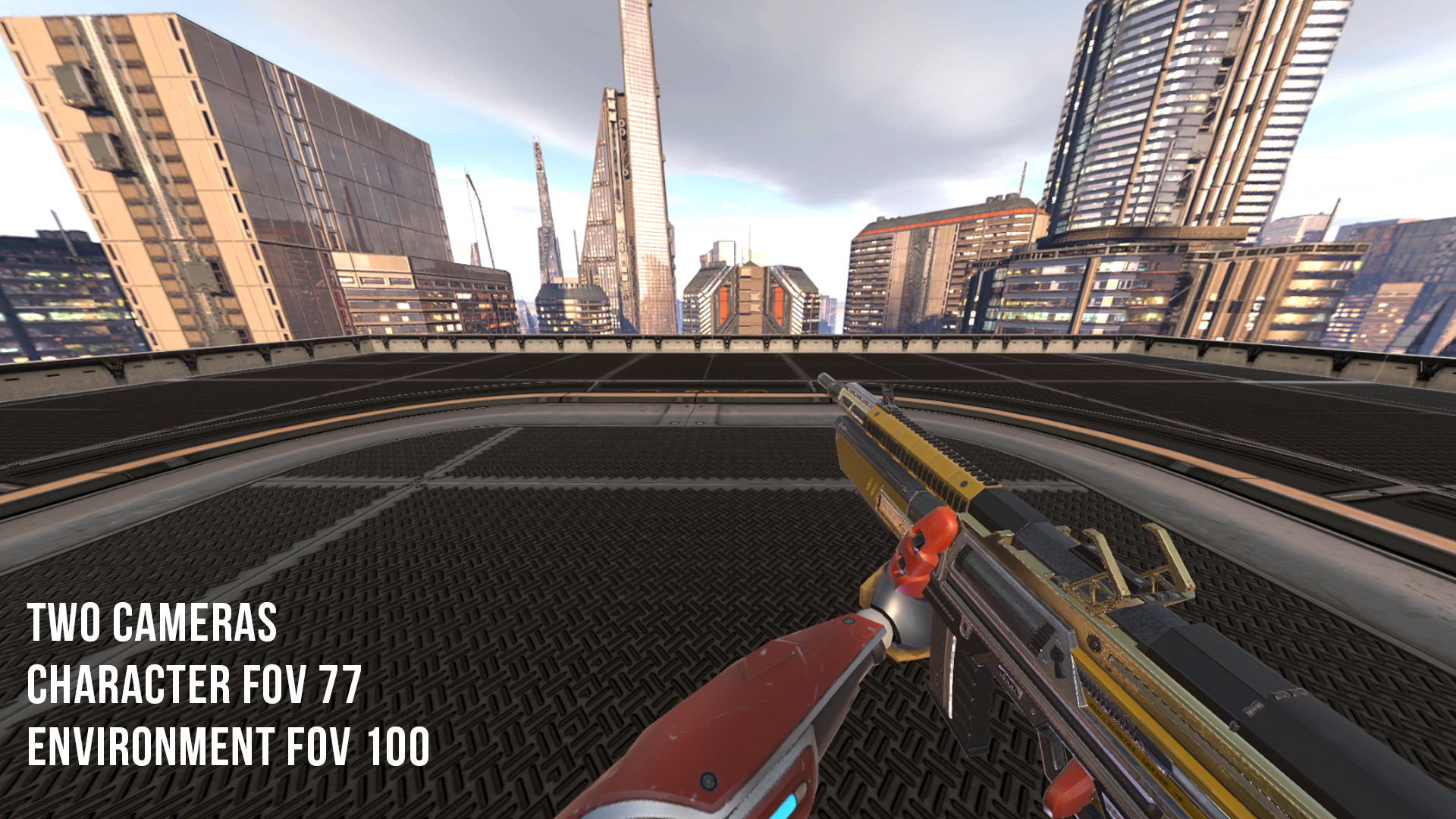

The field of view of your camera is going to be largely dependent on the type of game you’re creating. You may even have multiple cameras with different types of FoV values. First person shooter games often use two cameras with different FoV values for displaying the first person view, but another for displaying the environment. This often results in the player arms and weapons looking larger, while the environment stays the same. Below are some examples of different FoV’s in a first person perspective.

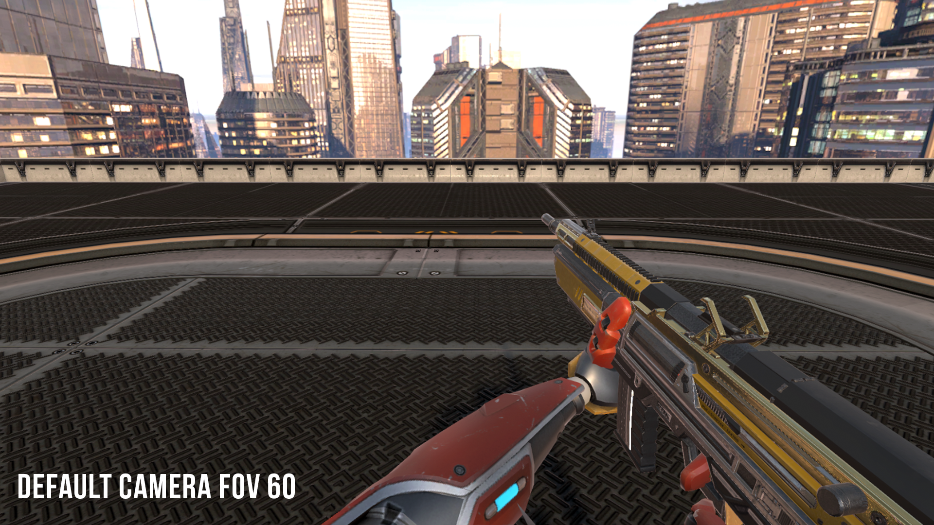

Default 60 Field of View in Unity
Two Cameras, one is set to render only the character with an FoV of 77 and another camera with an FoV of 72 to render the environment
A larger FoV may be preferred for fast paced games such as first person shooters. Plenty of players also want the ability to adjust their FoV. A larger FoV means more is being displayed on screen. A low FoV may be great for horror games or any games where you want to induce claustrophobia. Typically consoles have lower FoV usually for performance reasons but on PC it’s expected that FoV can be increased. Below you’ll find exaggerated examples of high and low FoV.
High FOV for environment means less player movement to see a larger area. Below the character FOV stays the same but the camera to display the environment is set to 100 which means we can now see the entire platform in front of us. This also creates the “fish eye” effect.

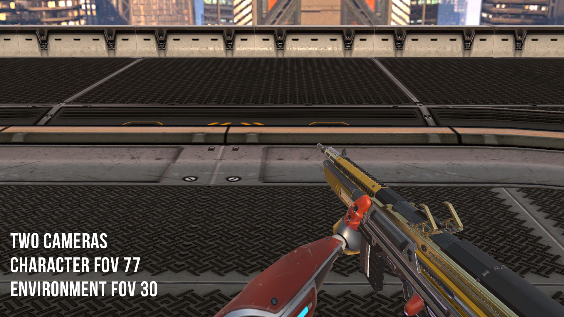

Low FOV feels uncomfortable and unnatural which makes it great for horror type games or anything where you want to simulate a tight space such as hiding in a locker or crawling through vents

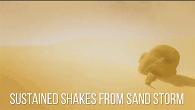

This effect can be used for consistent, or erratic movements that will shake the camera around in a few different directions randomly. This effect can also be used for a large vehicle crossing your area. Think of a tank driving by your player, a large rocket taking off, or even a heavy storm. Those would be sustained movements that could last a few seconds or longer.

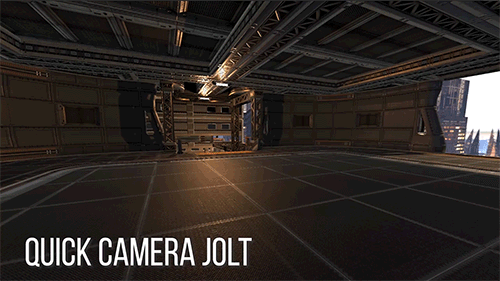

On the flip side we have erratic but quick movements such as explosions. Think of a grenade landing by your player and quickly exploding. Depending on your range from that grenade it may provide a violent shake, or a subtle shake but either way it’ll be quite quick, usually no more than a second in length. Below you’ll see examples of this at work.
Using the same effect as above, we can keep the shake very quick and abrupt to mimic the effect of an explosion. Here are two examples, which looks more impactful?

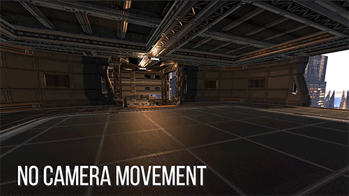

The same scene and effects in place, but this time with a quick jolt of the camera every time the explosion goes off. The first explosion is in real time, the second is slowed down by about 50% to notice the effect much more closely.
Take a look at this script posted belowto start adding some movement to your cameras for explosions and sustained shakes. In the script you’ll find a coroutine that will shake the camera based on the length you specify. Longer time means a sustained shake such as the sandstorm shown above. Very low time is useful for quick impacts such as the explosion which is using a time of 0.25 seconds.
Interested in trying out the script used for these examples? Take a look at the Camera Shake script and play around with the settings. It contains a soloStart bool so you can test it out using the Start method automatically, or you could also call the public method StartExplosionShake from another script or event.

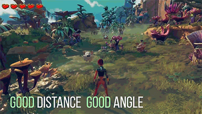

Here is an example from the 3D Game Kit that has a good angle and good distance from the player:
Note how I can see the entire player in view to see more of the surrounding environment easily. It’s also at a good angle so that I can see if an enemy or something important is in front of me. This type of camera is common in more open world games.

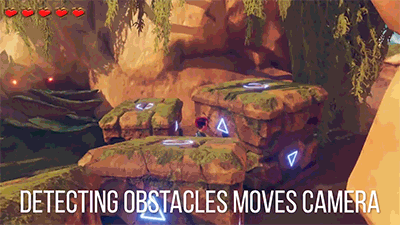

Another side note of this is the use obstacle detection with the camera. Here are a few examples showing how when I try to orbit the camera into an obstacle on purpose, it’ll automatically move the camera in closer to the character. This is good practice and prevents the camera from getting stuck in obstacles and obstructing the view.

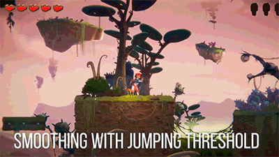

Here is an example from the 2D GameKit using a camera with “lazy tracking”, essentially it follows the player smoothly. The same general mechanics are found here, but this time they’re smoothed out a bit to feel more natural.

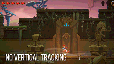

The two gifs above show the camera moving up and down when jumping, but there may be instances where you don’t want the camera to track vertically. Sometimes it helps to have the camera stay in place for specific movements. Again from this same 2D GameKit we see examples of this:
There’s no need to track jumping in a scene like this because we can see everything above the player. We are not expected to jump up onto any platforms above us so tracking horizontally is all that is needed.

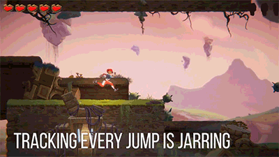

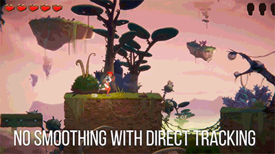

Here we have an example of no smoothing, again with the camera as a child and you’ll see how every jump is tracked which can be jarring to the player.
