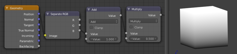

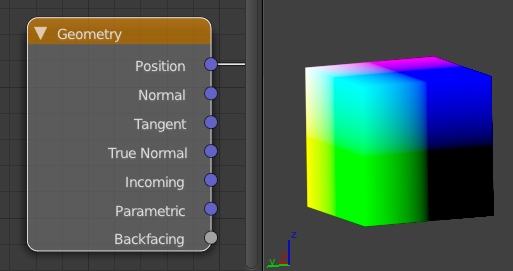

Did you hate math in school? I know I did! Unfortunately for us, animation happens to be one of those industries where math is actually pretty useful. While finances and statistics are pretty useless in this field, understanding interpolation types and coordinates can be extremely helpful. As shading artists, we can use certain aspects of our geometry as a part of our shader. Want to make something darker at the bottom and lighter at the top? Just use the Position output of the Geometry node:
02-position
03-gradient
The red, green and blue channels simply correspond to the position of each point on the surface on the X, Y and Z axes. Add 1.0 to the blue channel (the Z axis) to slide the gradient down, multiply it by 0.5 to stretch it to the top – and voilà! Sure you can do that with a gradient texture, but what about something more complicated, like the distance formula?
