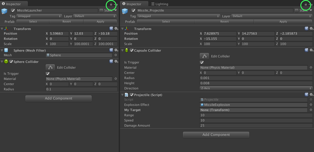

  2. If you need to compare two game objects with the inspector panel, duplicate the inspector panel, select your object, then lock that panel. You can then select your second object and see them side by side with two inspector panels.
    DualInspectorPanels

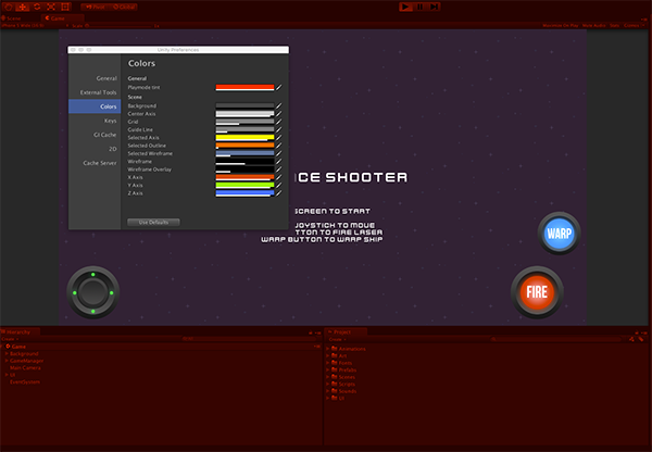

  3. You can apply a tint to the editor when in play mode. This is useful as changes made in play mode will not be saved, so having an obvious red tint visible when in play mode ensures you are aware.
    PlayModeTint

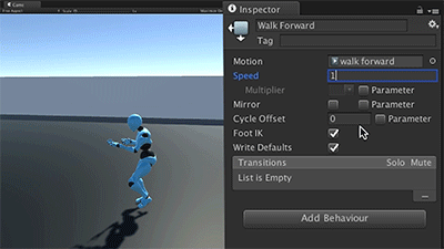

  5. You can reverse animation clips by adding a negative value for the speed. This works with generic and humanoid animations, e.g walk forward can be used for walking backward as well.
    ReverseAnimation

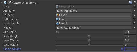

  1. Use the Range Attribute to add sliders to numerical values. If you’re working on a team this is especially useful since anyone who sets the values cannot add in a lower or higher value than you expect to use. It also makes things easier to look at.
    RangeAttribute

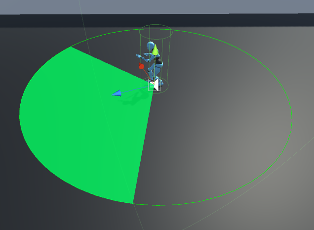

  5. Use the  Gizmos and Handles classes to test various game mechanics such as drawing a wire sphere to denote the range of an explosive in game or view radius of an enemy character:

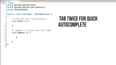

  8. When writing out loops/if statements/etc press tab twice to quickly autocomplete opening and closing parenthesis and brackets. e.g write out “if” followed by two tabs and see the code auto complete to a full if statement.
