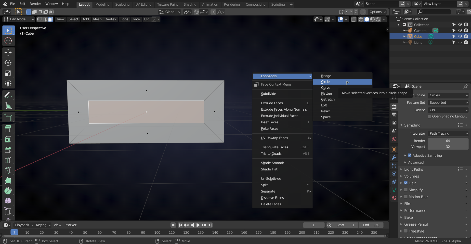

    Then in your Preferences enable the Loop Tools Addon.

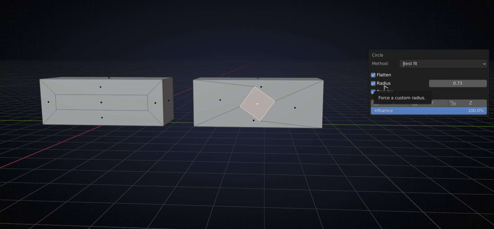

    Press W, or when you are using Left Click Select,  RMB to get to the Context Menu and:
    You might get a terrible mess, but check Radius to control the size of the square:

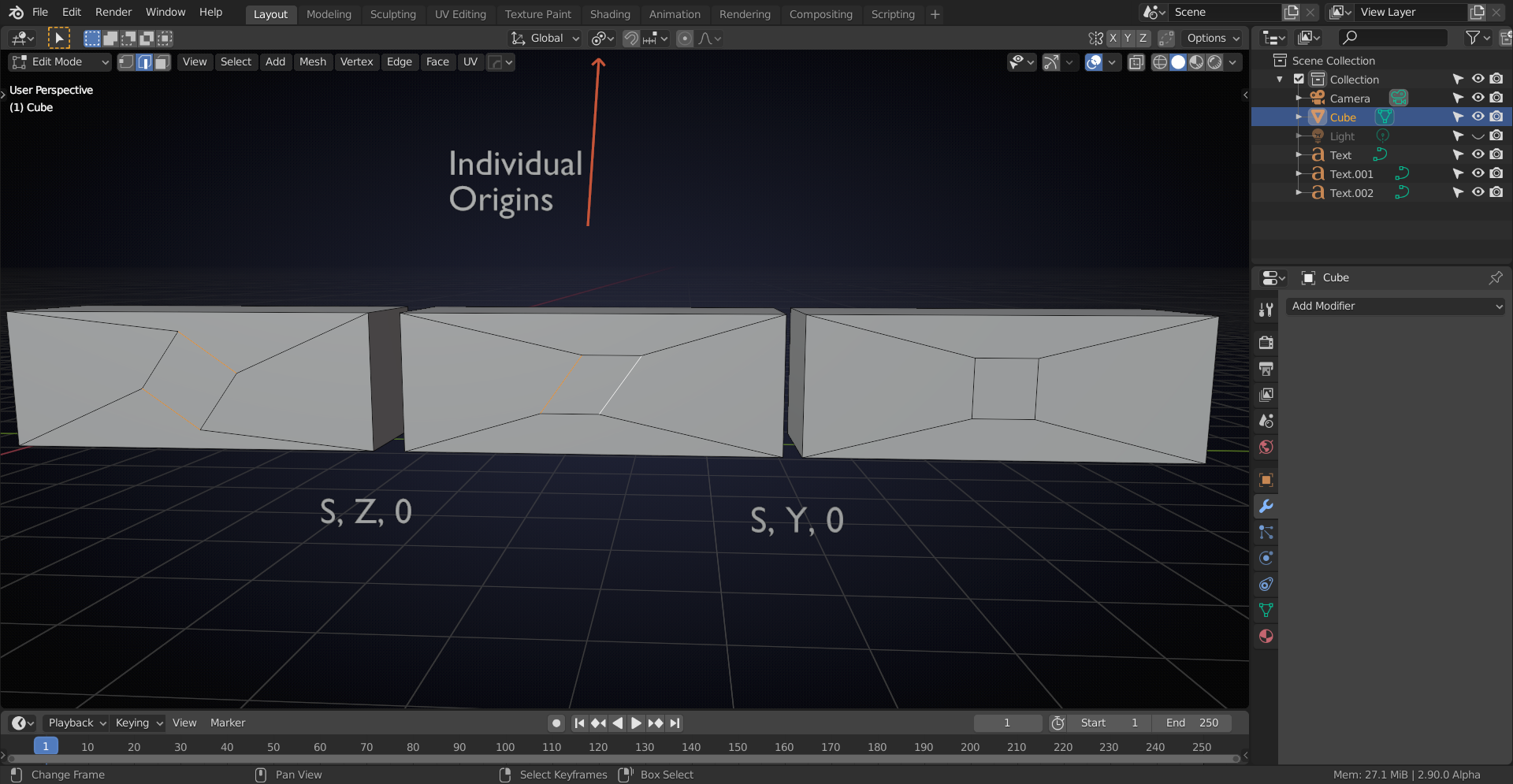

    Now rotate the square so that it is ‘aligned’ or to get it exact:
    select two parallel sides at a time and, using Individual Origins as Pivot Point, scale them to zero on the appropriate axes:

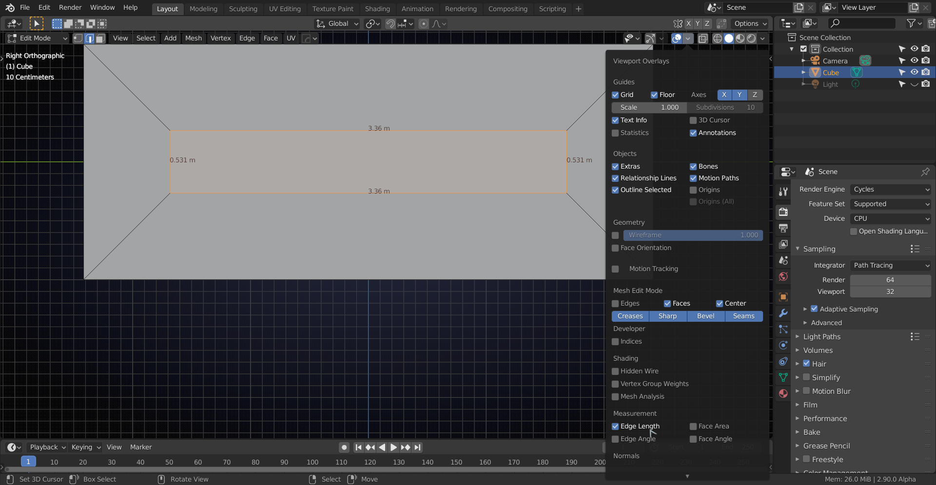

    Or, alternatively use the Edge Length Overlay and scale by hand:

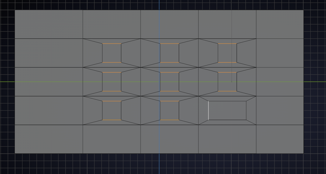

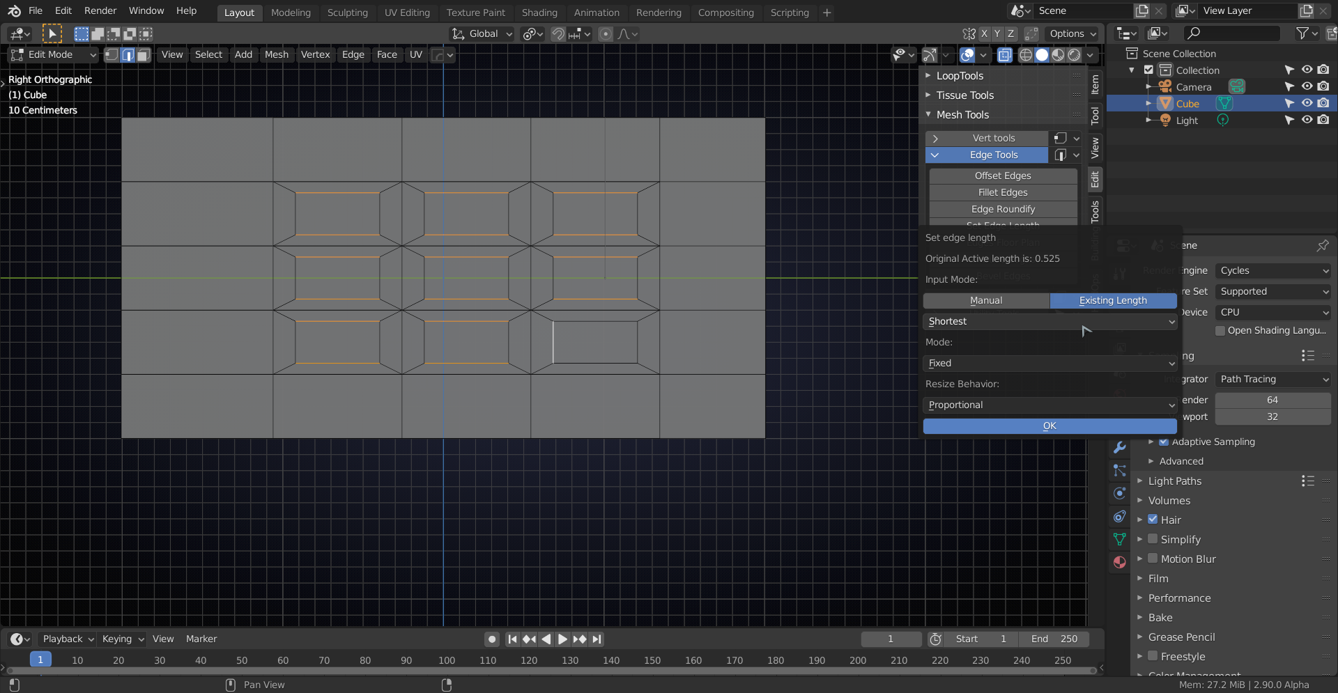

    Or, with multiple Insets like the keys on a keypad, you can enable the Edit Mesh Tools Addon and under Edge Tools use Set Edge Length:
    to get:
    Notice that you’ll have to do that twice, because this tool doesn’t allow you to have Edges that share vertices selected.
