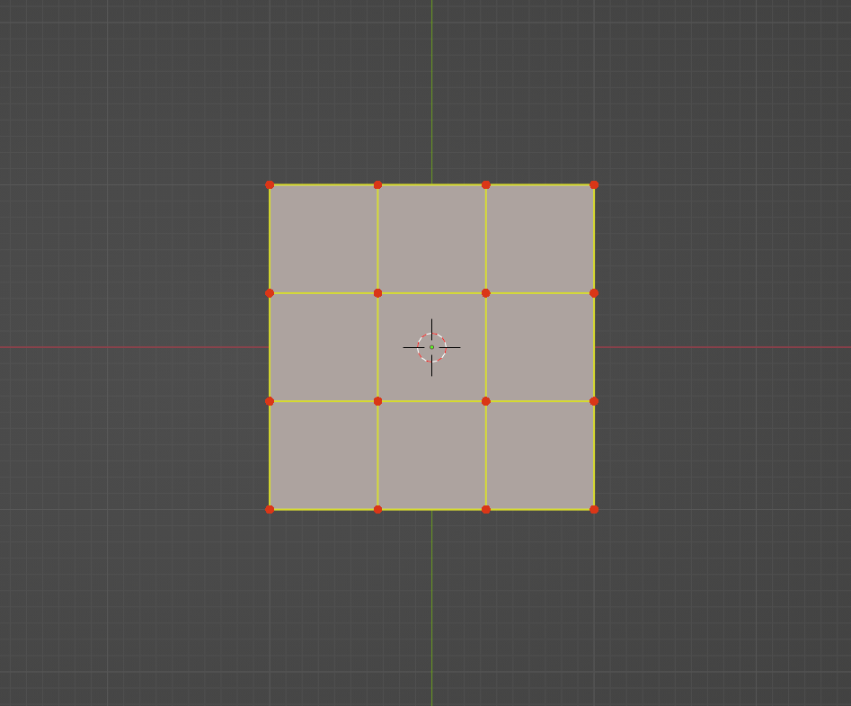

    Hi Scott @blake4xx ,
    it looks like it’s not ‘constructed’ correctly (the fact that it has 3 different colors is also an indication of that)…
    You can try M > Merge > By Distance, but that might not work in this case.
    It’s probably best to make it new.
    An easy way of doing this, is to Add a Plane (in Edit Mode of course) and Subdivide it (with 2 cuts):
    and then simply Delete the 4 corner Vertices.
