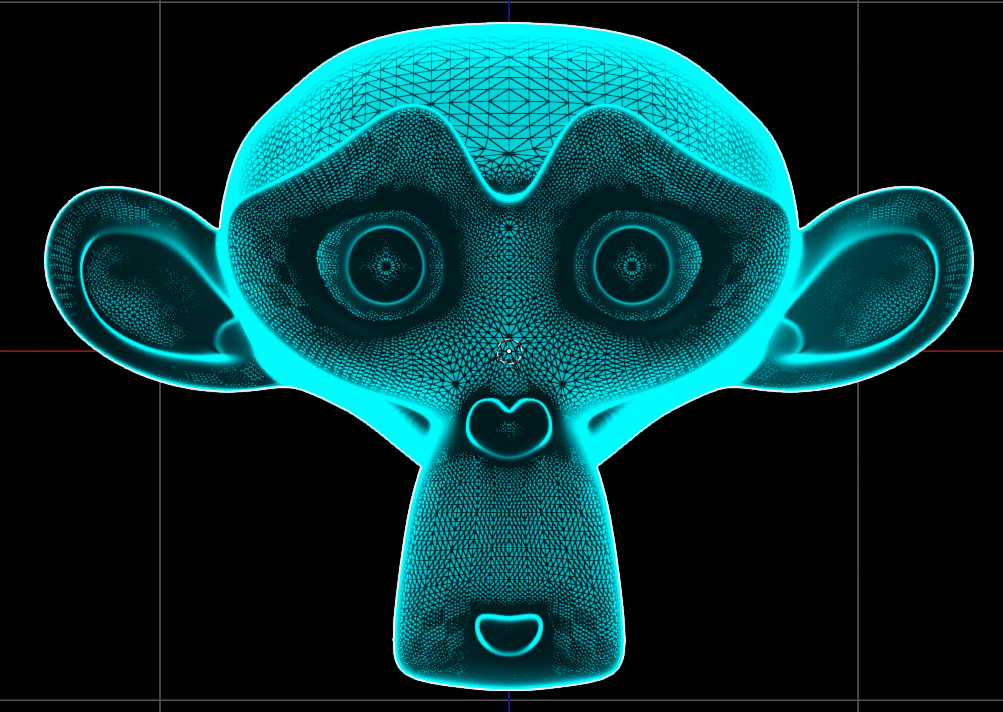

    The first thing I decided to work on is the monkey. For starters, I followed Kent’s ”Hologram Shader” on Shader Forge series. That placed me in the right ballpark. Then I modified the shader – first by switching the wave texture for a Voronoi texture, and then connected a wireframe node to the Voronoi’s scale.
    While this was a good start, it still needed some tweaking. For example, there wasn’t enough transparency. I overlaid the “backfacing” and “Pointiness” portions of the geometry node, and lightened it with the brightness/contrast node. Still, it needed further tweaking.  After a few searches on YouTube, I fiddled with the options slot in the materials tab. It worked! All that needed to change was setting the blend mode to “Alpha blend.”
