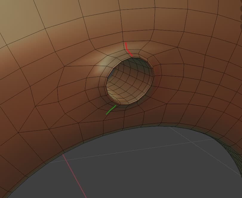

The reason for this ‘weird shading’ is the topology.Look at the difference in the edge flow from the top and bottom.I marked the harsher angle (red) to highlight the difference with the smoother (green)
