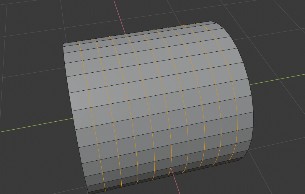

    I used a Cylinder for this example and divided it, so that I had more or less squares:
    Select what you want:

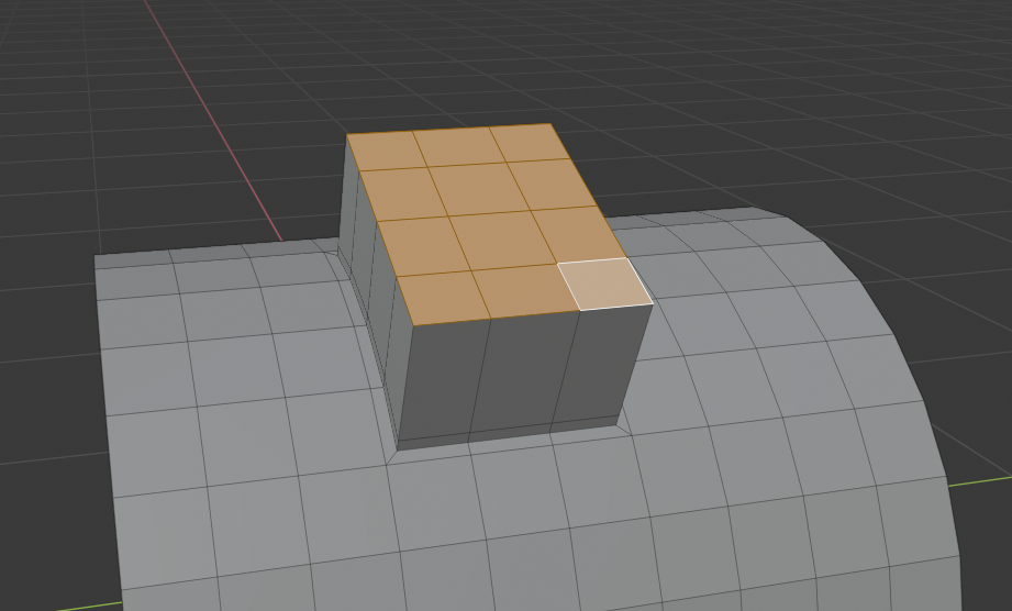

    Inset:

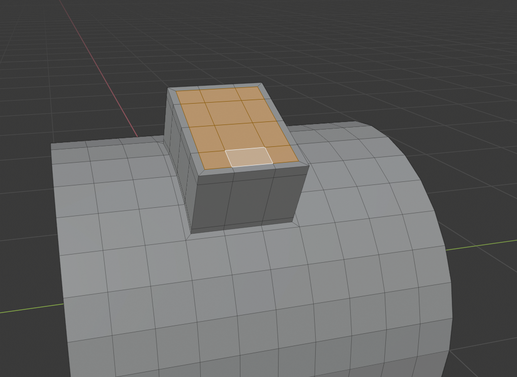

    Extrude a bit and the extrude again:

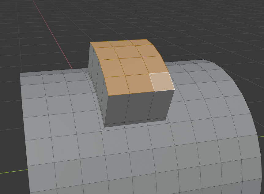

    Flatten the top (S, Z, 0 with Transform orientation changed from Global to Normal!):
