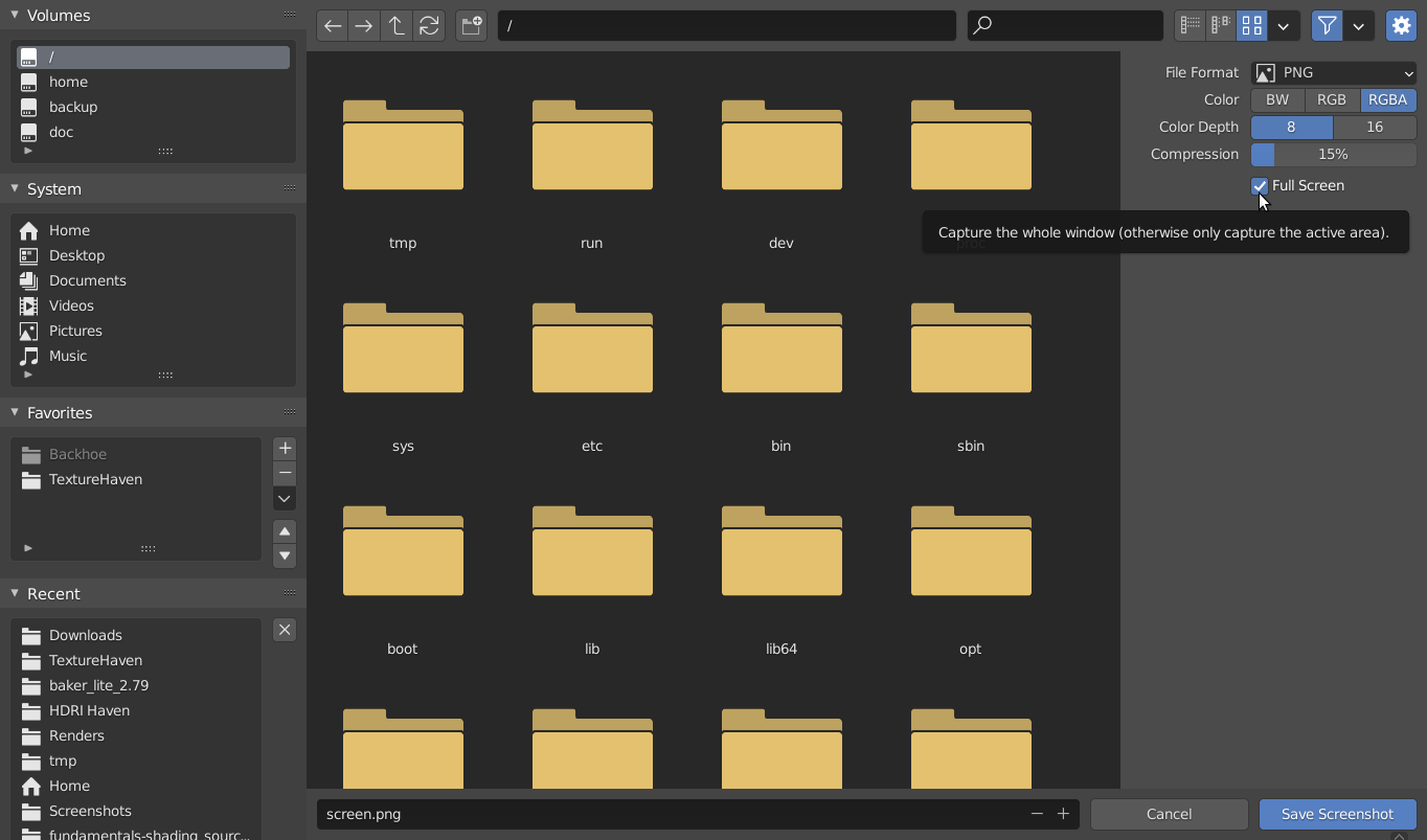

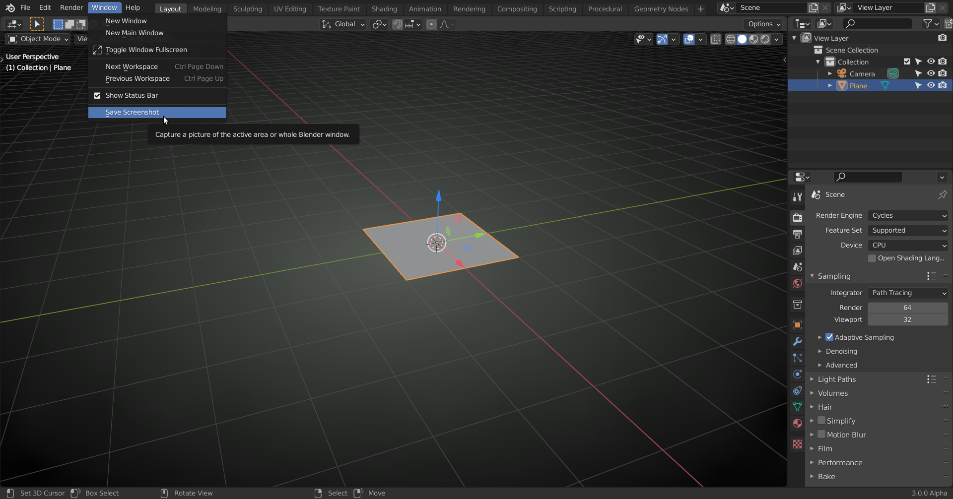

    Btw.: for Screenshots you can go to Window:
    The default takes a Screenshot of the whole UI, but if you press N in the File browser, you can change the Settings:
