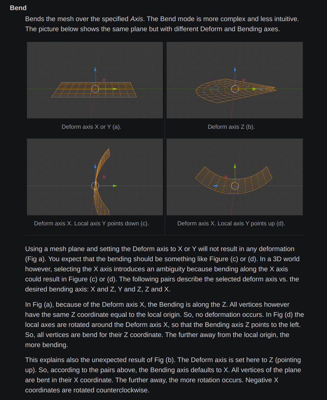

    Hi Nolan,
    that is indeed not completely straightforward; maybe the Manual can help:
    Mind you, there is a typo in the third picture (c), that shoulb be Local axis Y points to the right…
    I usually use an Empty as Origin in the Modifier, that way I can Rotate and Move the Empty to get more and ‘easier’ Control over the Bending.
