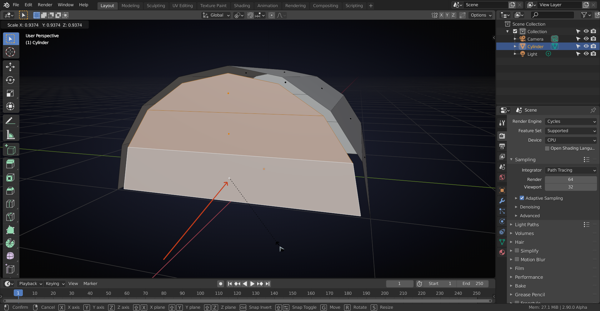

    You are scaling towards the active element:
    which is in this case the lighter colored bottom plank and to be more precise: the center of the plank:
    So everything (that is selected) shrinks towards the center of that bottom plank, so also the bottom of that bottom plank scales towards that center.
