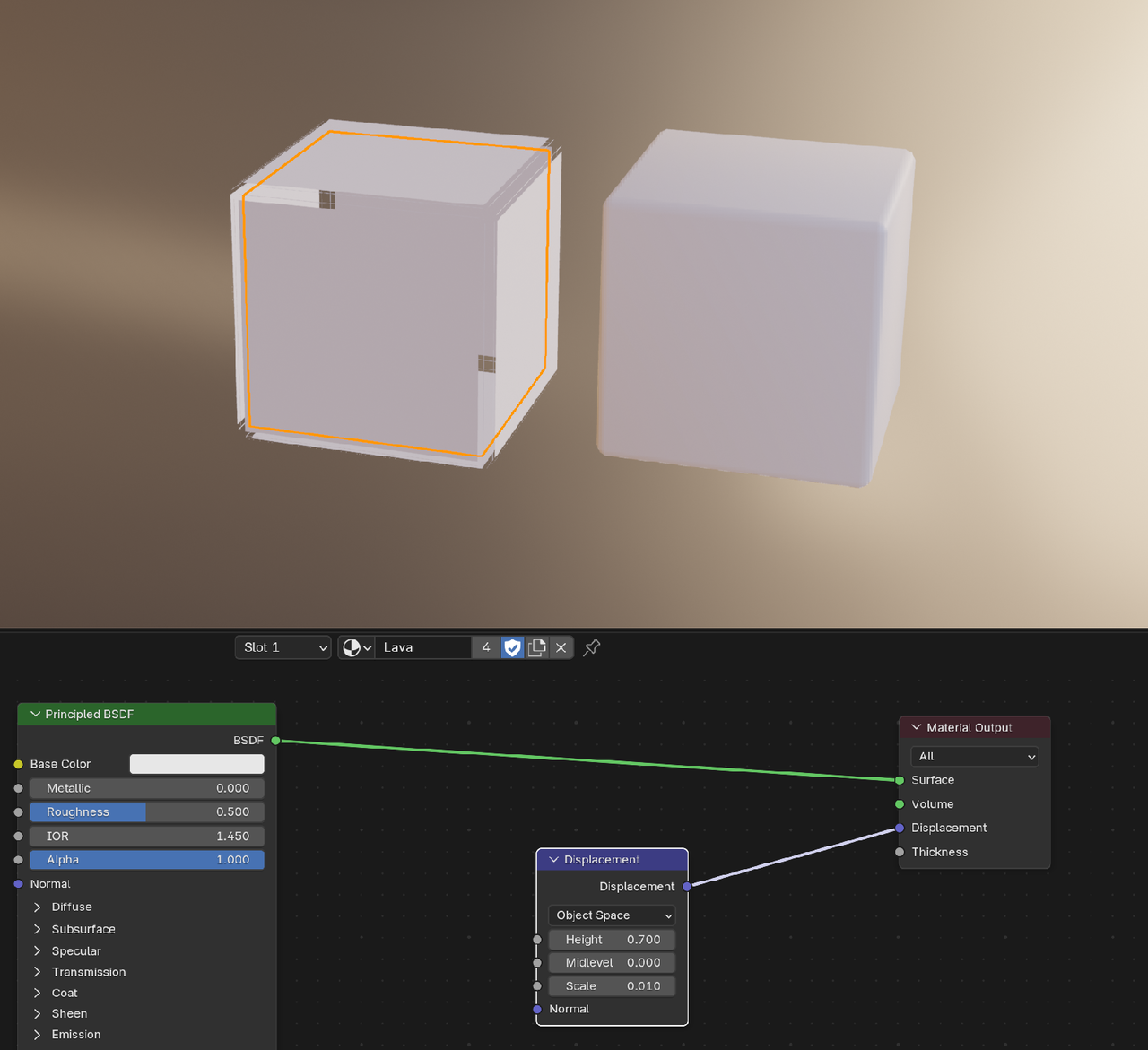

    It is a known Limitation of EEVEE. If you set the Object to Shade Smooth, the Displacement will work correctly:
    https://docs.blender.org/manual/en/dev/render/eevee/limitations/limitations.html#shader-nodes
    Let us know, if you got any more trouble with mixing the Textures.
