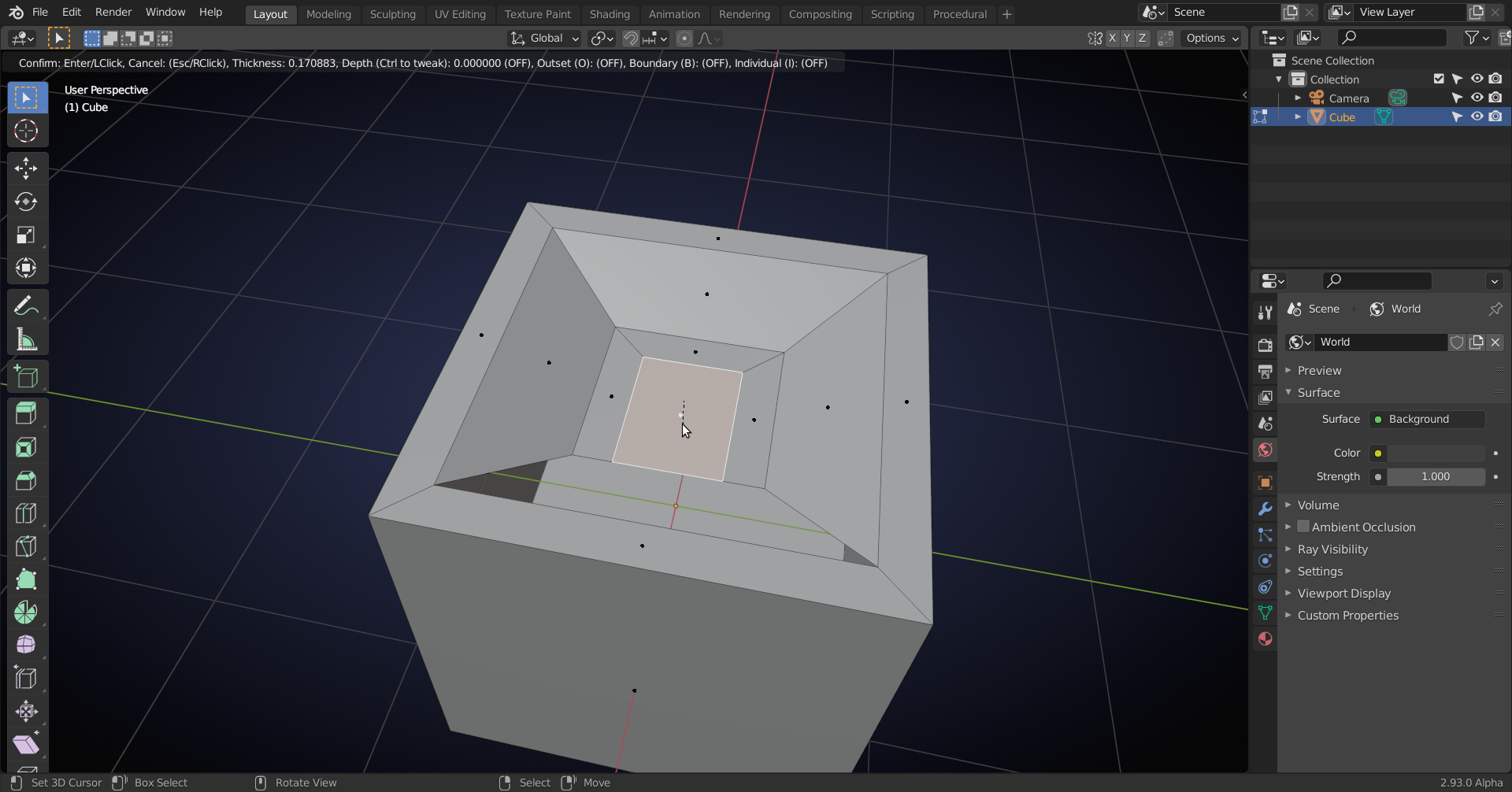

The Inset operation (I) has several options, also the possibility to turn off/on the Boundary (B):
(Look at the top of the 3D Viewport…)
