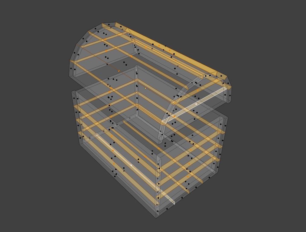

    In your treasure chest, you have inside faces:
    Select them all and press X > Delete Faces.
    Then select all edge loops where those faces where:
    Press V (rip), immediately followed by Enter, to separate all the planks.
    Select everything with A and then press F. This magically fills all the planks, keeping them separate. (Make sure the F2 Addon is enabled!)
