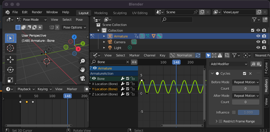

    Hi,
    I am guessing you aren’t selecting the channel (channel needs to be highlighted) to  add the modifier. I’ve done this many times  before.  This was with blender 3.3.1,  Also make sure you haven’t turned the modifier off, checked x above the before mode and that. you have the correct options in before mode and after mode selected.
