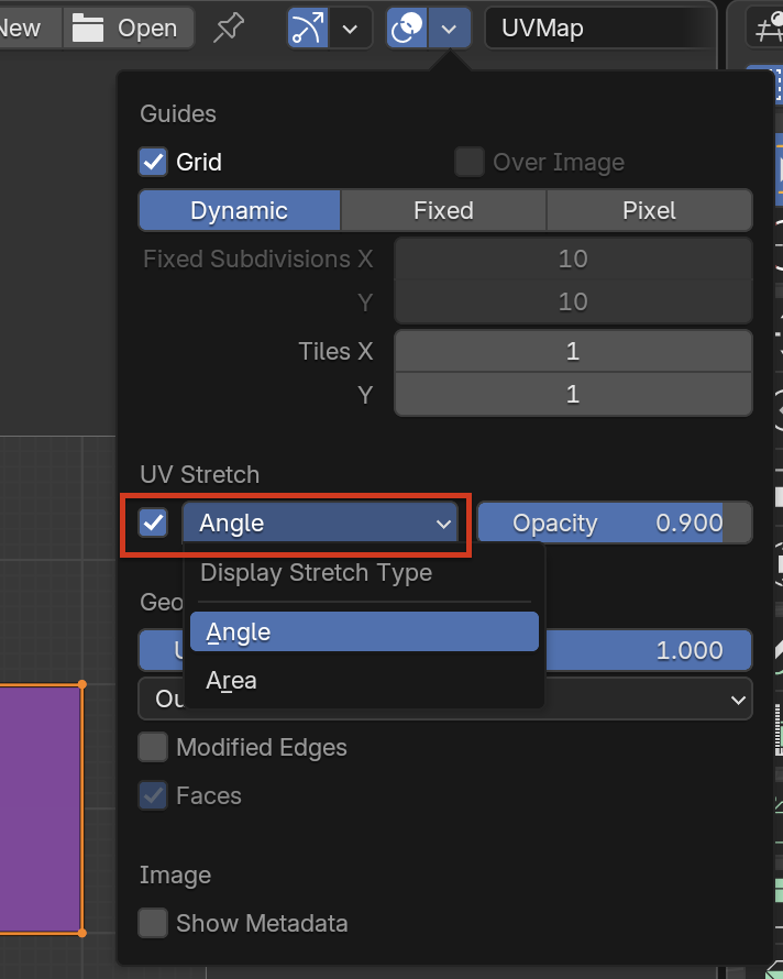

    You can turn on UV Stretch to see if your island is stretched, change it to the two options of Angle and Area:

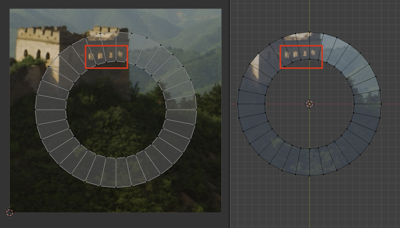

    The UV island being rounded isn’t going to round your texture, because you can think of the texture as being flat and the UV island having a circled shape, but it’s just mapping the flat part into the circle, not giving it a circled shape. I think it will help you to do some experiments. See how it’s just mapping the flat image into the flat circle, it’s not bending it and twisting it to the circle:
