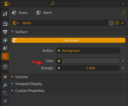

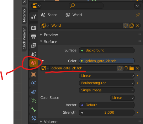

if there is no light source then it is likely an HDRI environment
check under the world properties tab…
default no environment image
with an environment
hope this is helpful…
