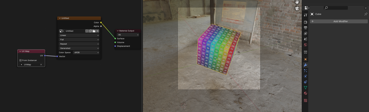

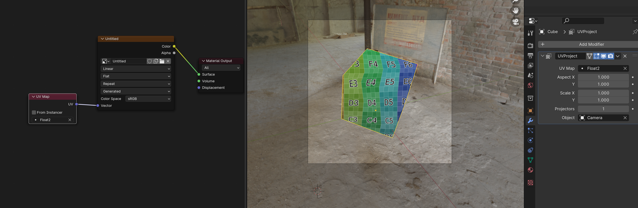

If you have two different UV Maps, and you have the UV Project Modifier set to one of them:
Then Apply the Modifier and switch to the other (or any other) UV Map:
(Of course) it won’t make a difference if the Modifier is still intact.
