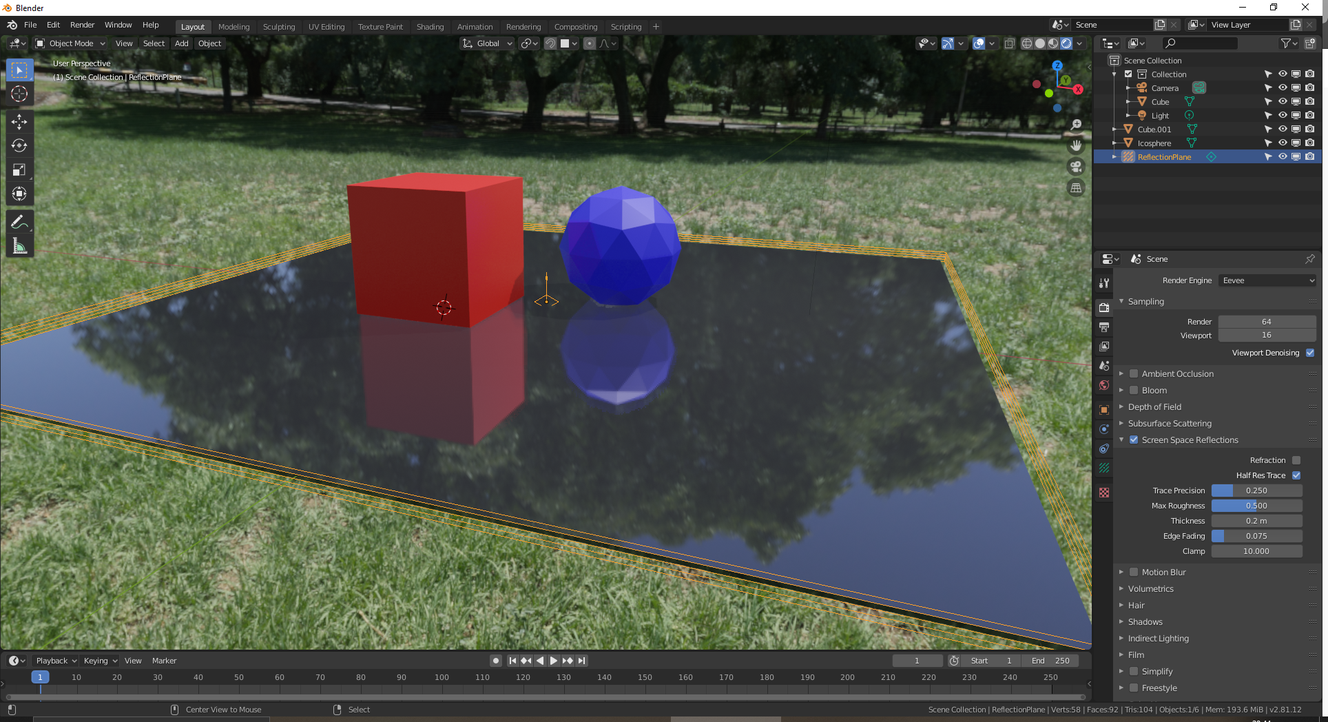

    You may need to enable screen space reflections to enable reflection of non static objects, you may also need to add light probes

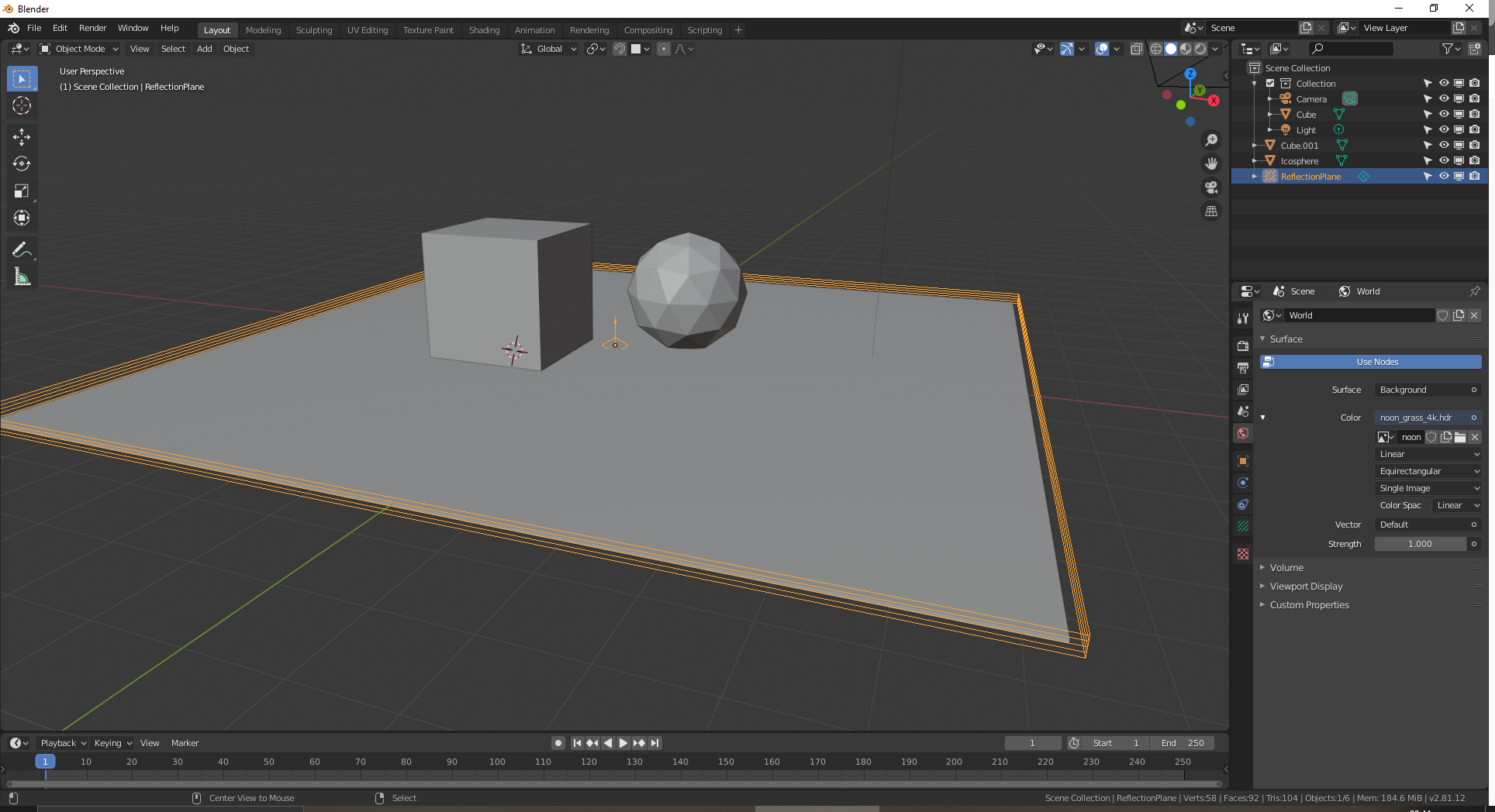

    As shown in these screenshots i added a flattened cube reduced its roughness to 0, turned on screen space reflection and added a light probe for planes that surrounds the flat part and it creates a mirror like finish.
