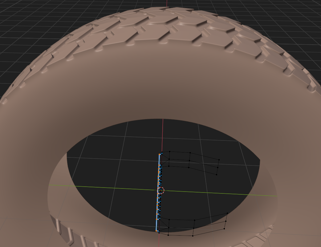

    Hey Nazinin,
    It looks like it is probably the depth of the tread is too great, the image below shows the selected vertices I moved along the Y axis to reduce the depth by approx half. This is on the rubber_high object.
    Try that and re-export the high poly, and use the new one in InstaMat.
