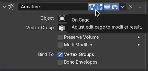

    As for the vertex weight panel, there needs to be an active vertex.  If you select a bunch of them at once there is only selected vertices and not an active vertex.
    Just shift click 1 vertex and it will show that panel.
    As for the ‘springing back to the original shape’, this is an option on the modifier.
    Do you see the 2 icons on the left (where my mouse is)
    Enable both of them.
