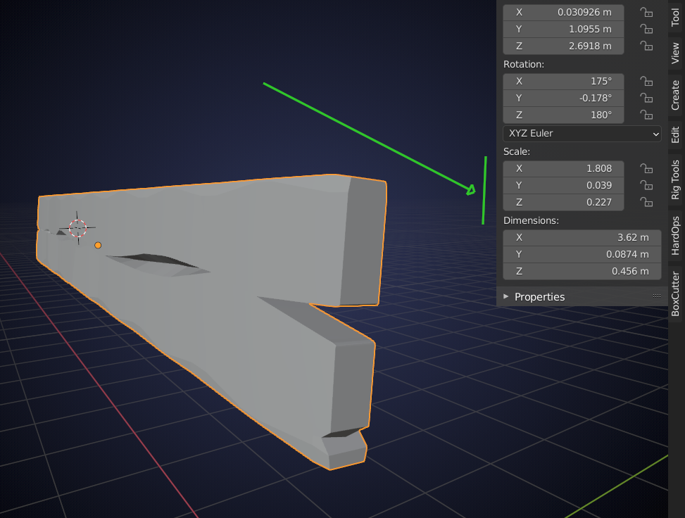

    The Plank you are showing here has a non-uniform Scale:

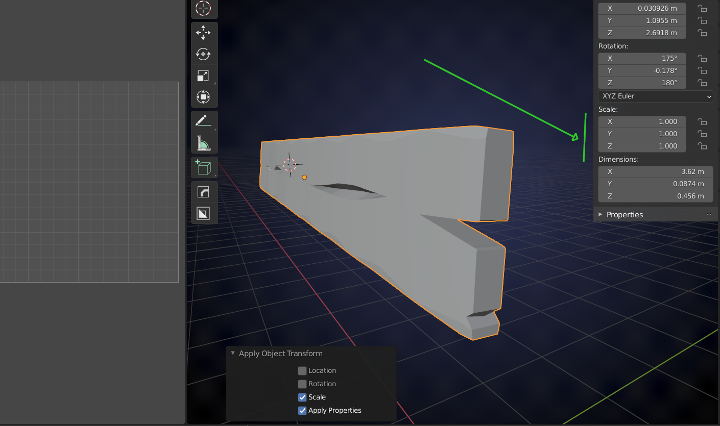

    CTRL+A > Apply Scale:
    Then Unwrap again:

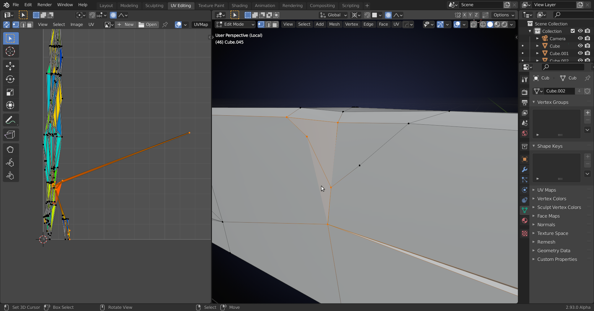

    As for the bottom Planks: this is not supposed to be there:
    But that’s a plank on the backside; the ones on the front side look okay now. You can simply mirror them on the Y-axis to get the back. No one is ever going to see the back and front at the same time, so they won’t notice the mirroring 😉
