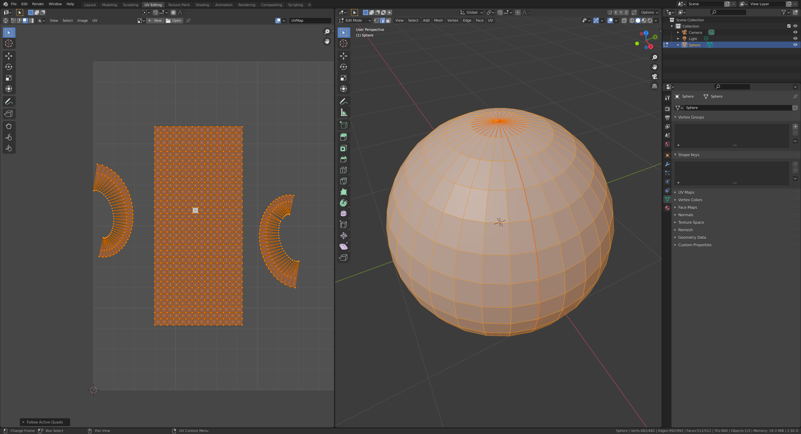

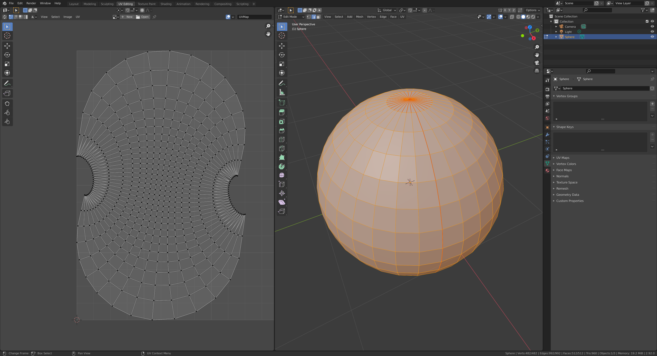

    What seems to have separated the spikes into islands is that I’ve treated the initial (now reproduced successfully) unwrap with ‘follow active quad’ (a tool completely new to me; didn’t assume that only quads follow quads (am I on the right track now at least?? : D )and drop the tris)…
    the funky unwrap (now acting as expected, as far as the overall integrity is concerned) but with heavy distortion as a tradeoff:
    distortion addressed, at the cost of a single continuous map being broken down into three:
    Although the initial problem is somewhat solved, I would still appreciate any tips and suggestion on this (both specific and more general) kind of solutions from the people with more UV experience…
