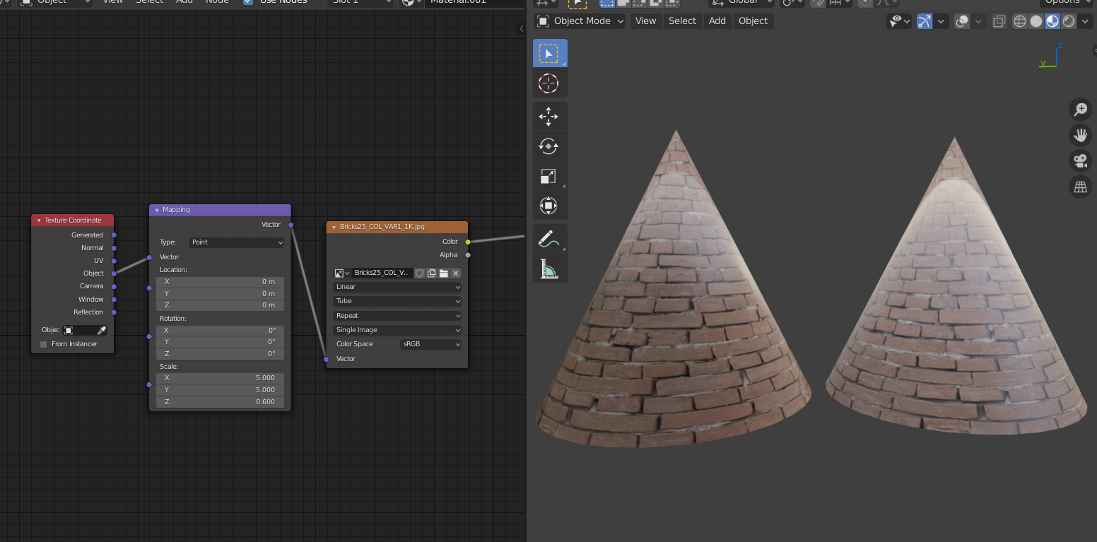

    Hi polyrom3d, in this case, you might get away with a Tube Projection like this:
    No UV’s needed. There is a small artefact, but that is easily hidden by rotating the cone (if it’s not at the back already).
    To be clear, the Tube Projection is set in the Image Texture, between Linear and Repeat.
