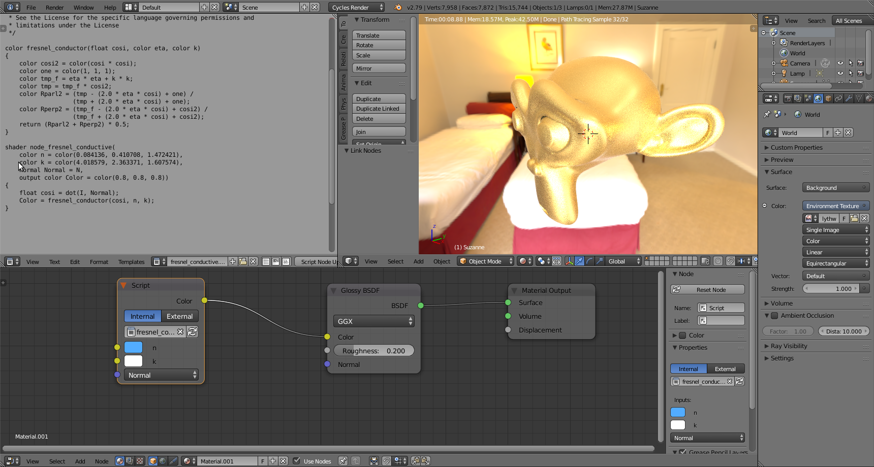

    To be more precise, a Vector (purple) socket expects X, Y, Z values and they can each range from – “infinity” to +”infinity”, while RGB values are typically between 0 and 1 (but there are exceptions, for instance with realistic metal shaders that use a complex ior, like here:
    as you can see, the color n and k are using values greater than 1 here.).
