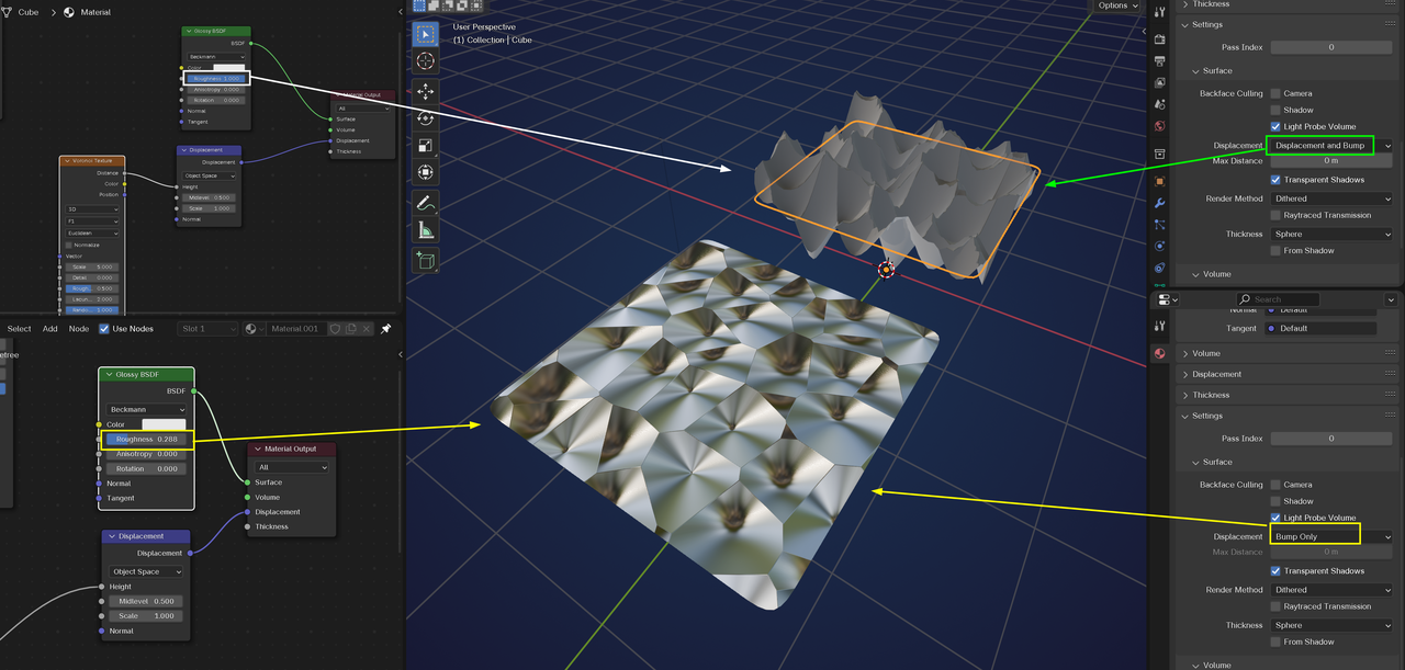

    Hm,
    It almost looks like you don’t have any real Displacement; dpn’t forget to change the Settings in the Material Tab to Displacement and Bump and maybe try increasing the Roughness of the Glossy, to get rid of distracting reflections from the Environment that is being used in the Material Preview Mode:
