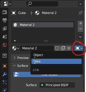

    Yes you can have linked objects use different materials. By default the link in the material is set to Data, meaning if you change the material in one, all the other objects that are sharing the data will get the same material. But the link feature in the material can be changed to Object, which will allow you to set a different material per object will they remain linked.
