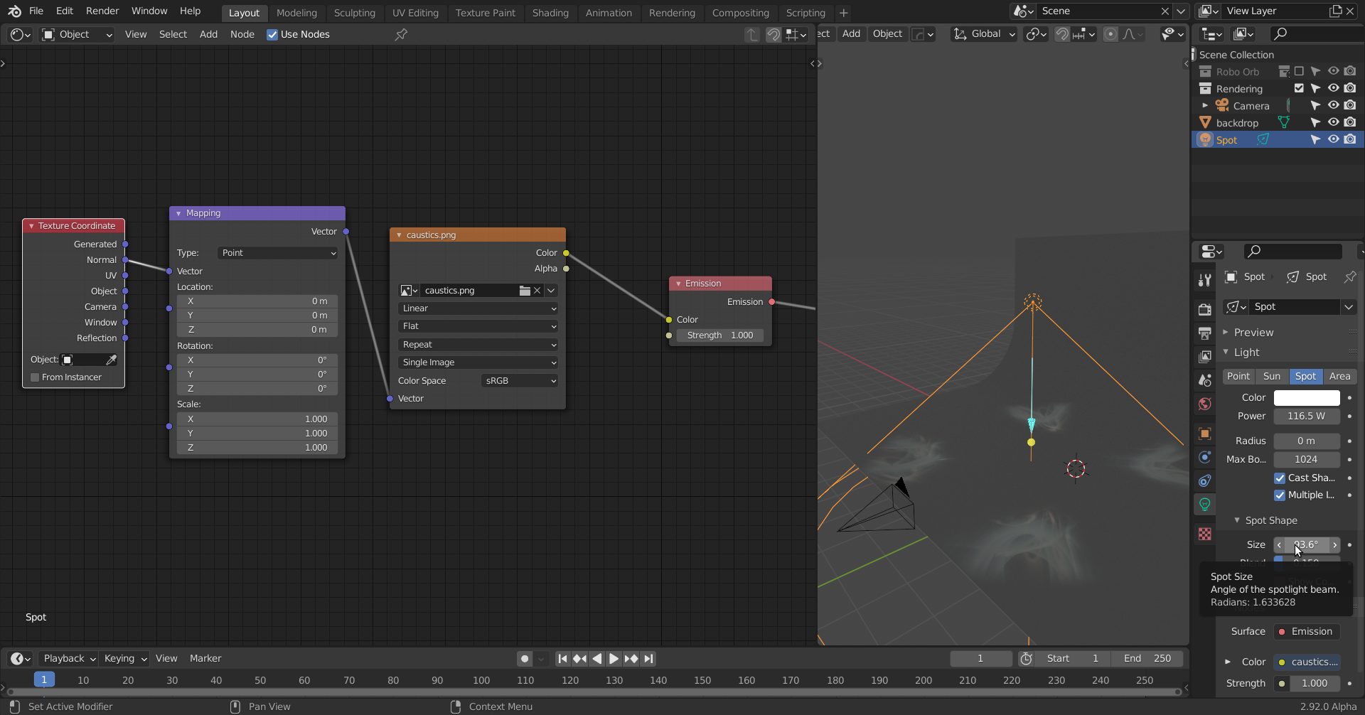

Hi Julian, the texture is outside of the cone of the Spotlight:

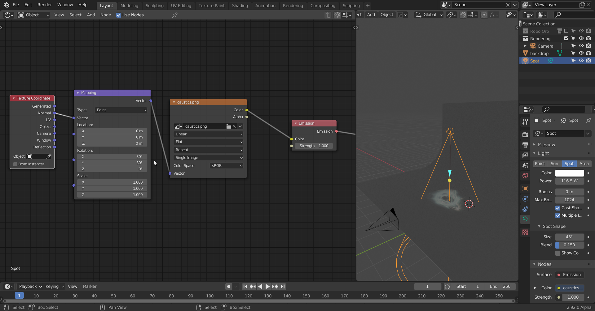

Try rotating the Texture:
This is probably also the solution to your other question (with the Flashlight Texture).
