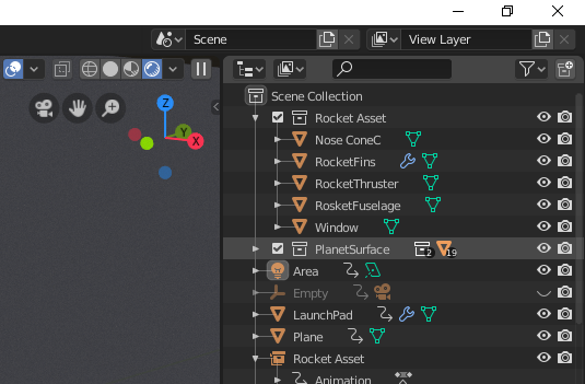

    @frederica , you should leave that top Rocket Asset unchecked:
    Just enable visibility of all these important parts before that:

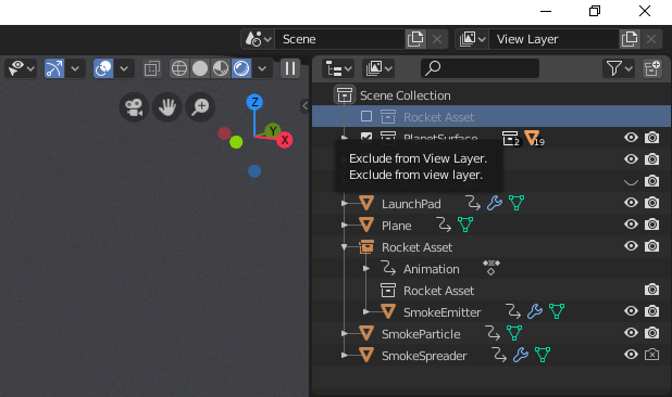

     And all will be fine:
    Why is this happening? The first rocket you created is the original rocket. The properties of the original rocket are transferred to the copy that you are animating. Therefore, there is no need to turn off the visibility of the original (the copy becomes invisible too). But disabling the original in the scene is exactly what needs to be done.
