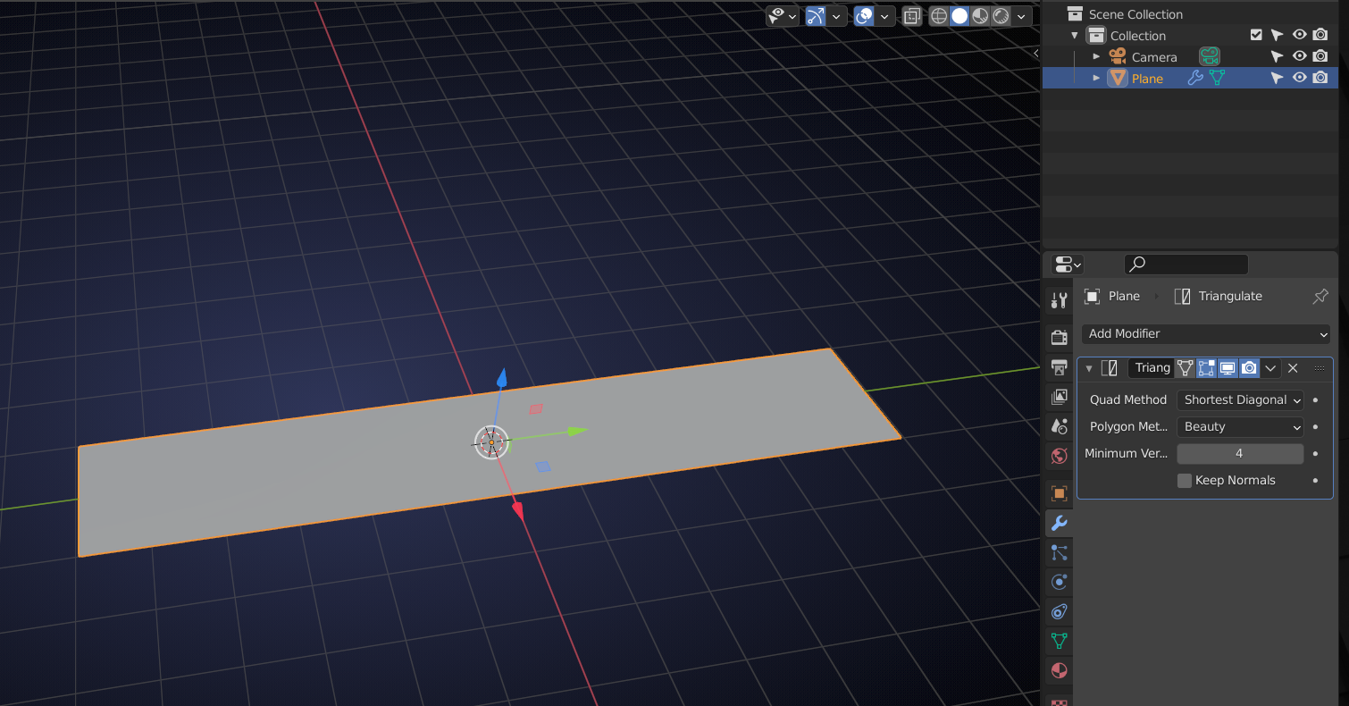

@iii1brain the Triangulate Modifier is probably working, but you just can’t see the effect:
What you can do is go into Edit Mode to see the efeect, or,like in the video (the step you are missing) is to use the Wireframe shading:
