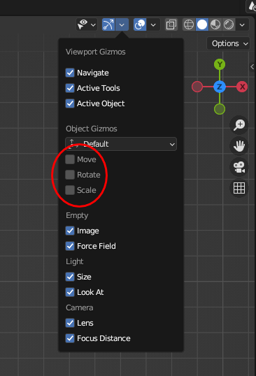

    The transform gizmos are probably disabled.

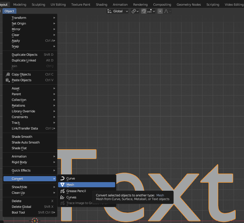

    To convert text to a mesh,
    Make sure the text only is selected, then go to Object > Convert > Mesh.
    Note: you won’t actually see any change, until you tab into edit mode where you will see the editable mesh.
