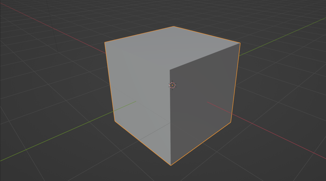

    Example:
    A cube is still a cube regardless of the number of vertices and how messy the topology…
