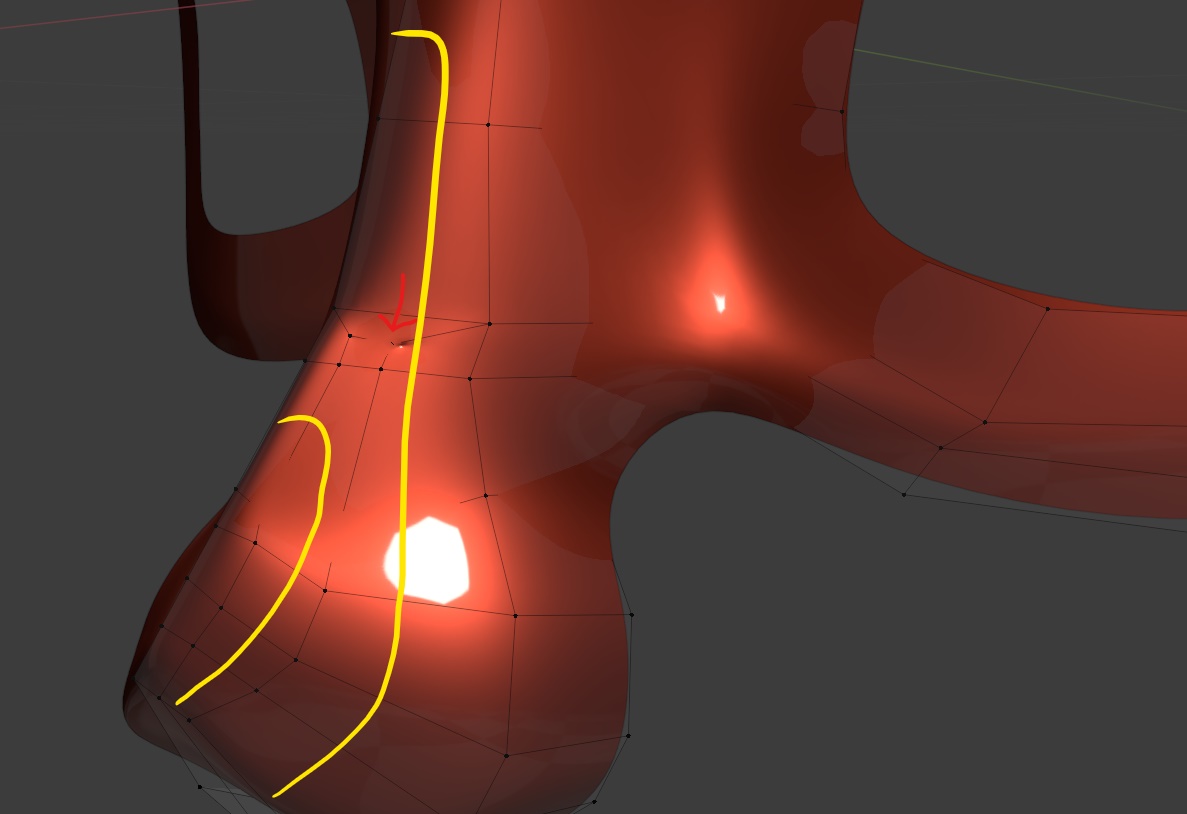

    Good question! Try not having that face loop run up and back down the nose, but rather have two of them cross over the center line like so:
    It may also be possible to run one around the nostril in the other direction. I don’t remember exactly what I did in the video, but it was probably something similar.
