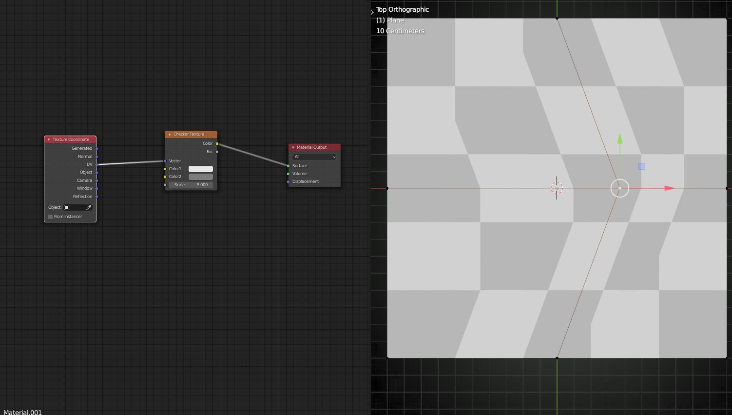

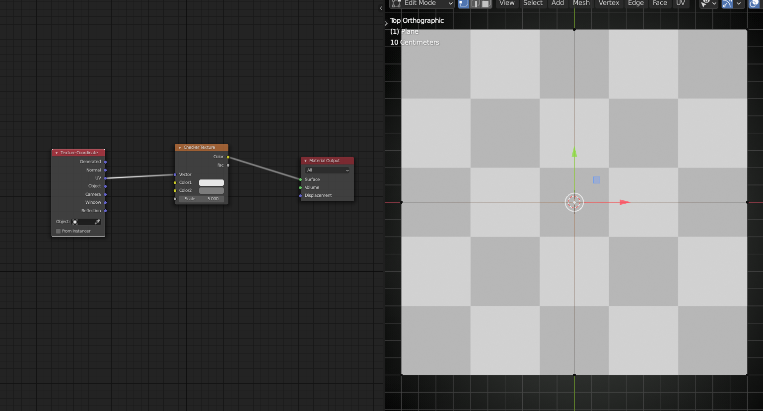

    If you have an Unwrapped Plane:
    and move the center Vertex, you distort the checker pattern:

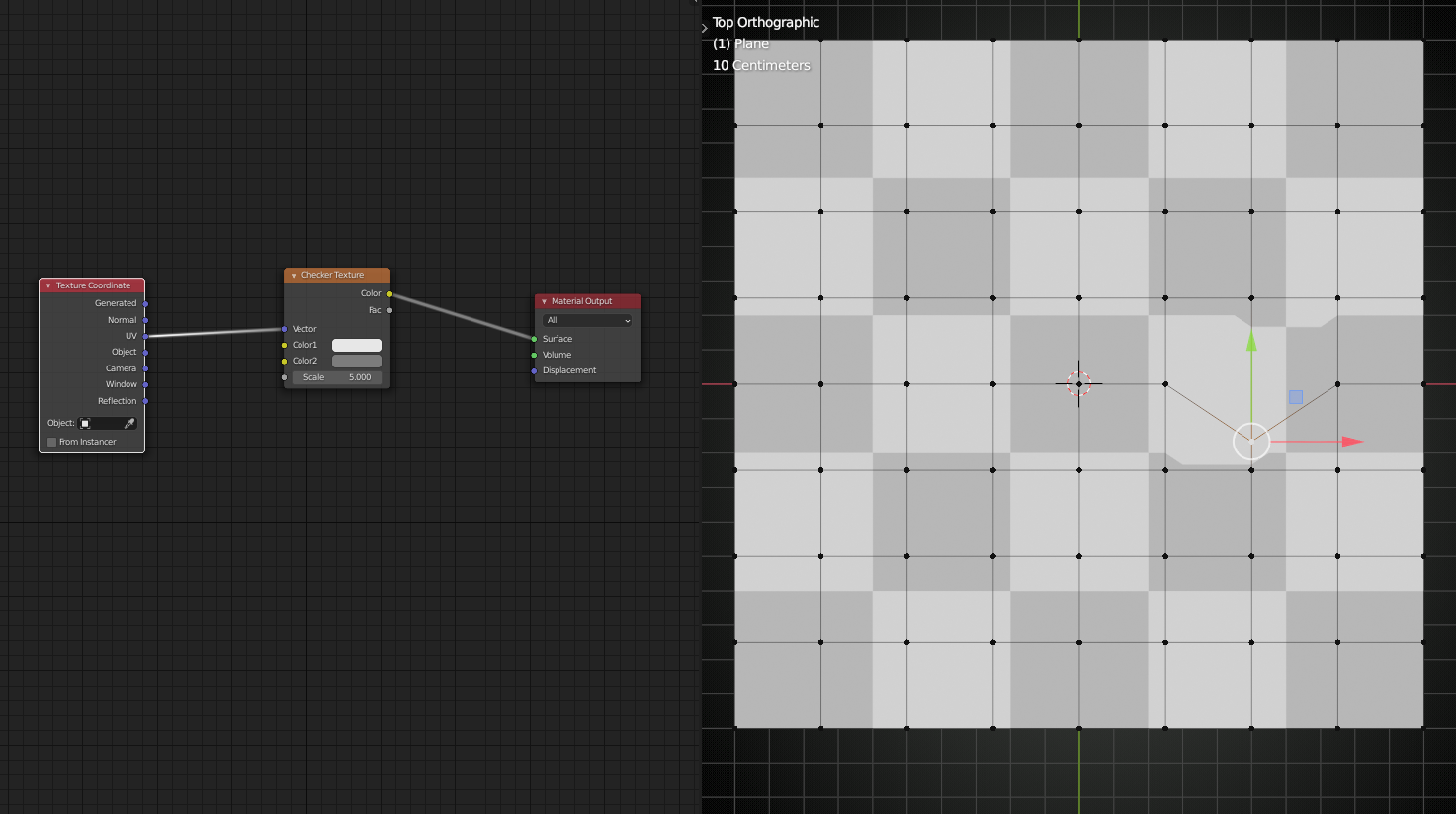

    If you subdivide it first like this:
    and move another Vertex, it will  (and should!) still deform:
    This is expected and wanted behavior! (But I can understand your confusion and hopefully have helped you understand what is happening and why a little better….)
