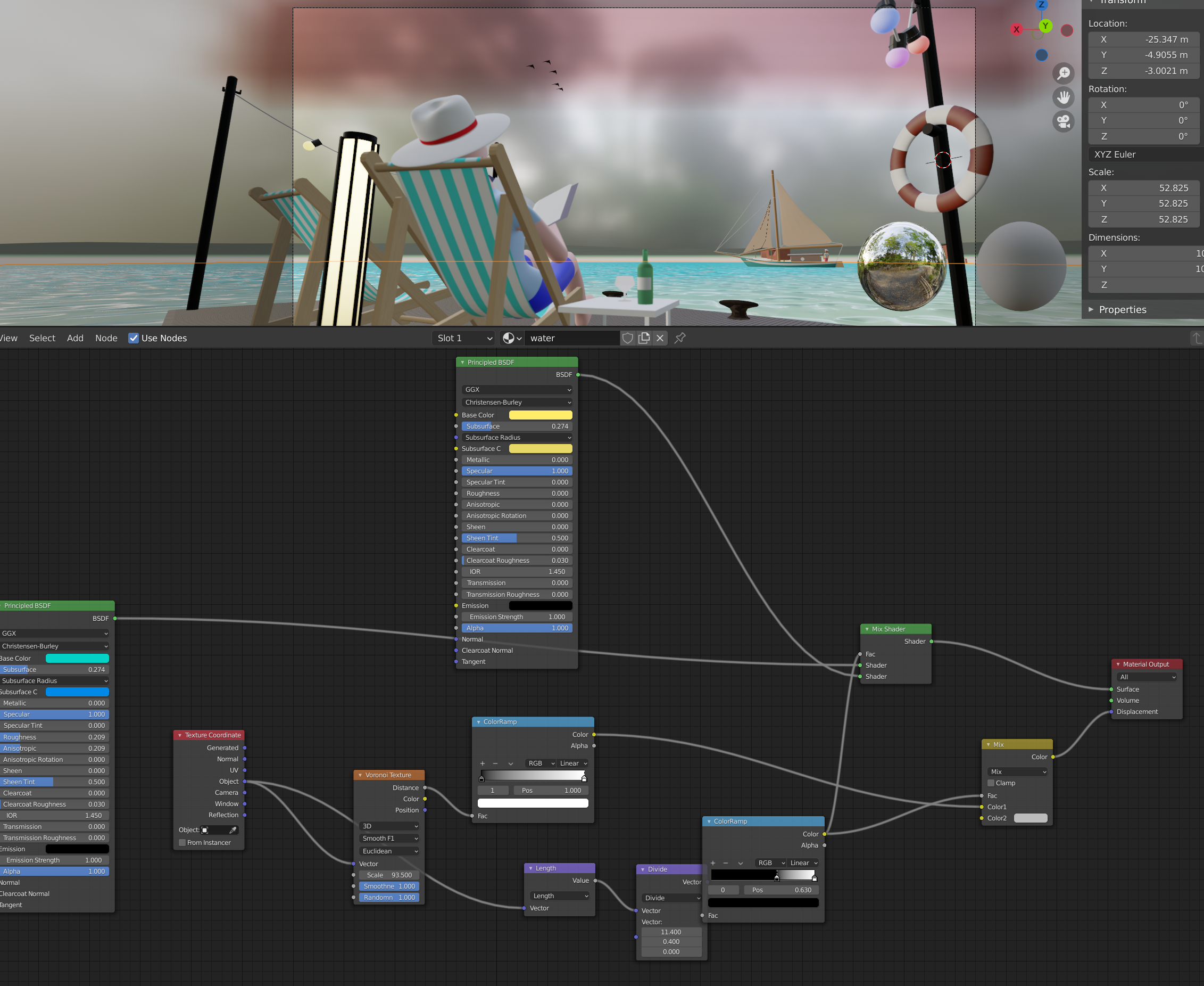

    A bit of documentation for some elements I previously added:

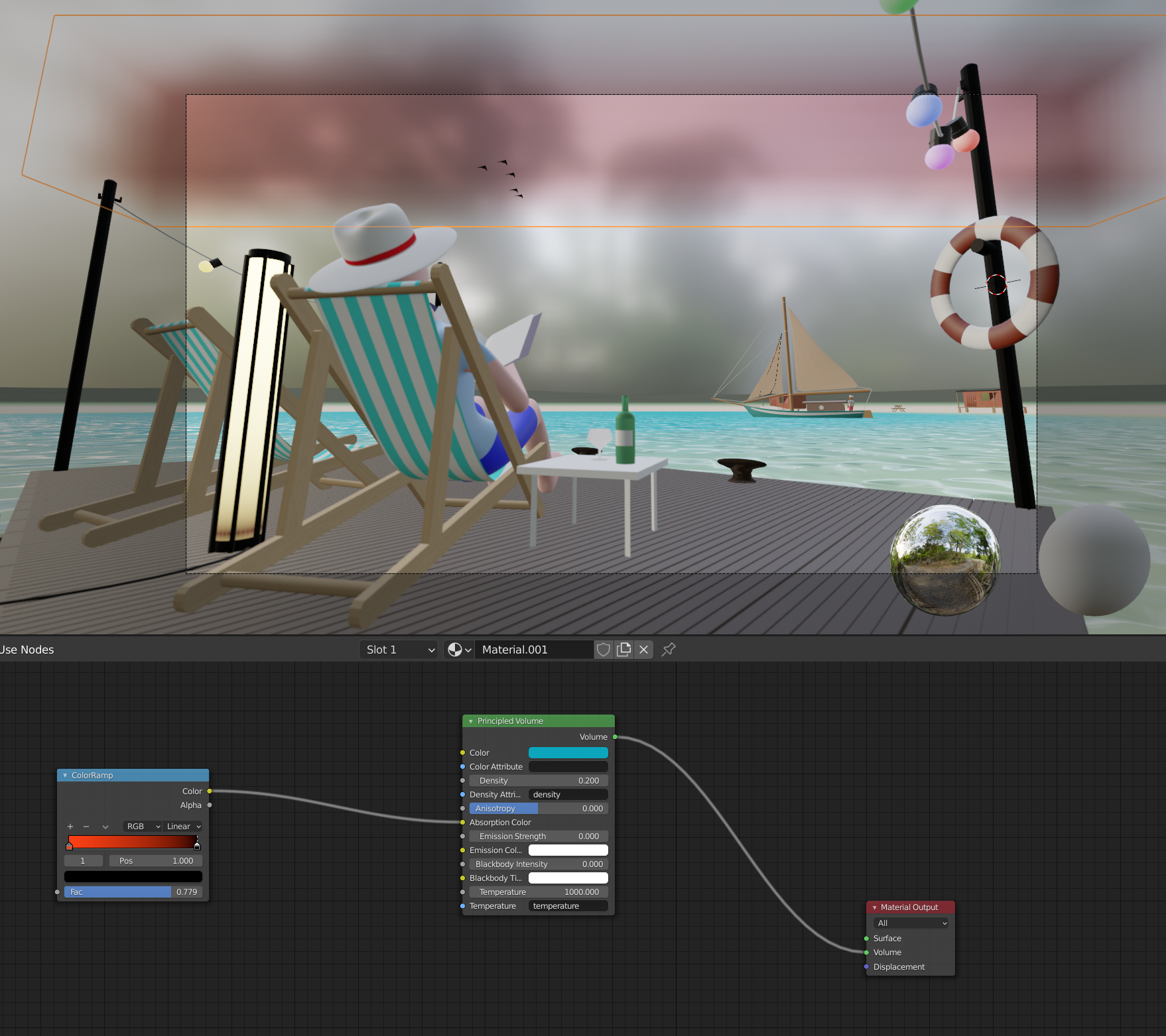

    the dark “bruckheimer” effect on top is a volume shader
    The water was created using voronoi displacement and a length math shader to create a very aquatic blue and more yellowish water color the more you get too the border.

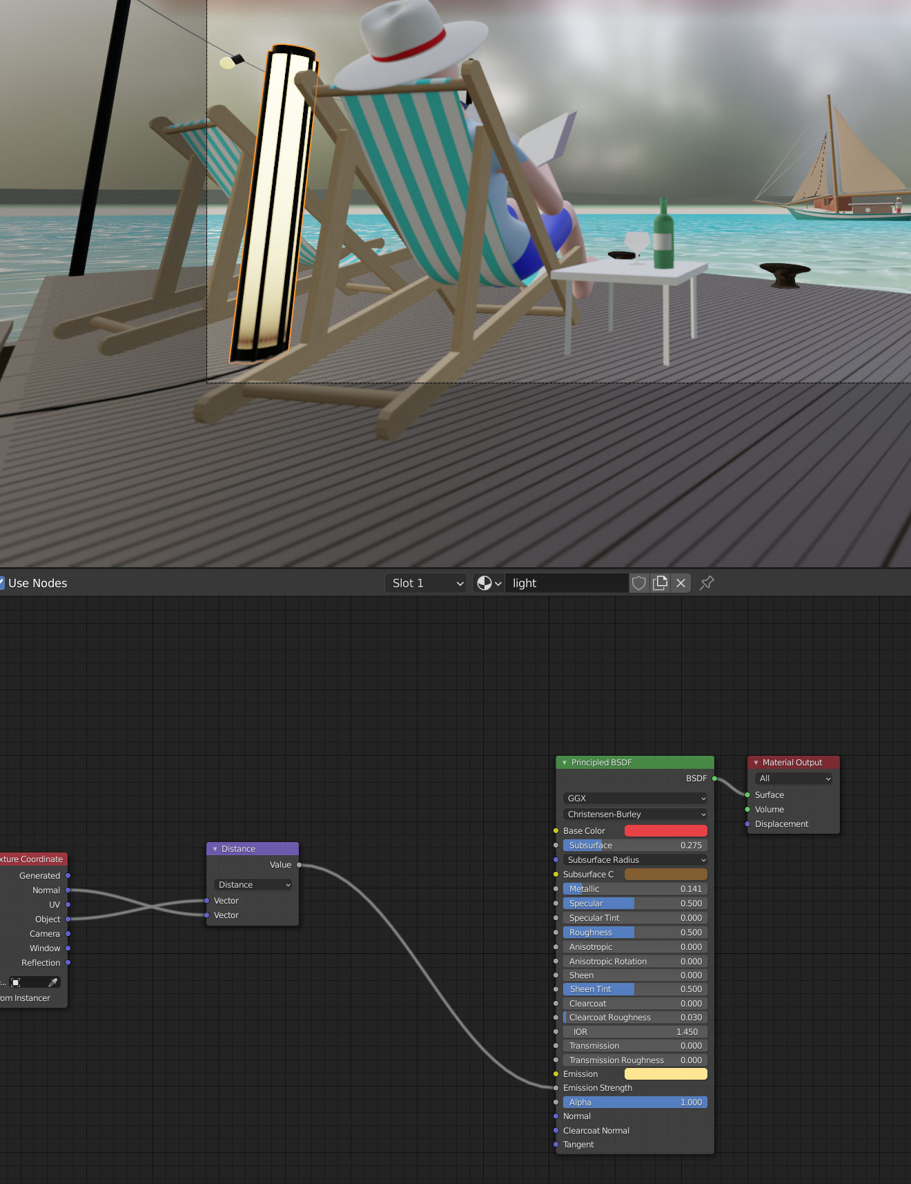

    For the lamp on the left of the man I used a distance math shader based on 2 coordinates which creates a really nice effect on the bottom of the lamp:
