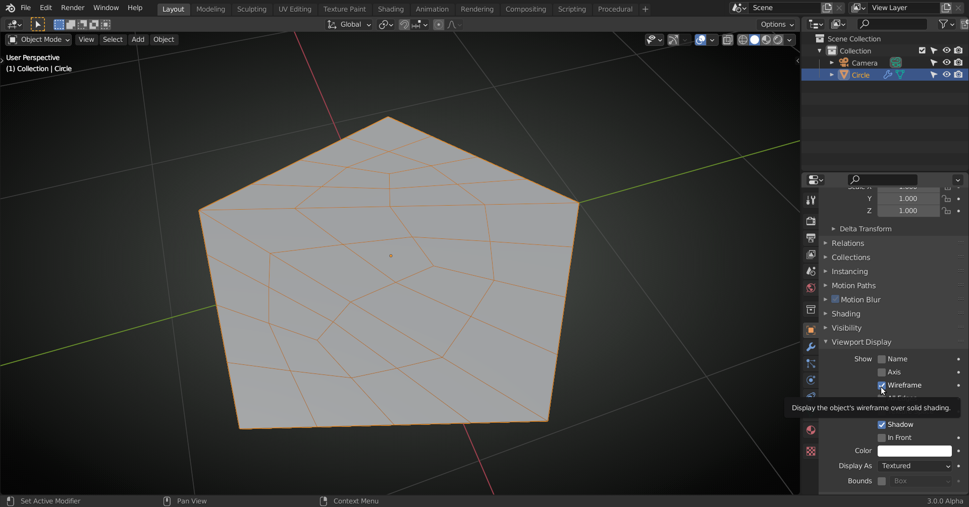

    @christopherward you also need to enable the Wireframe. Either here:
    which is a ‘per Object’ setting, so it will only show the Wireframe in the Objects where you have this enabled.

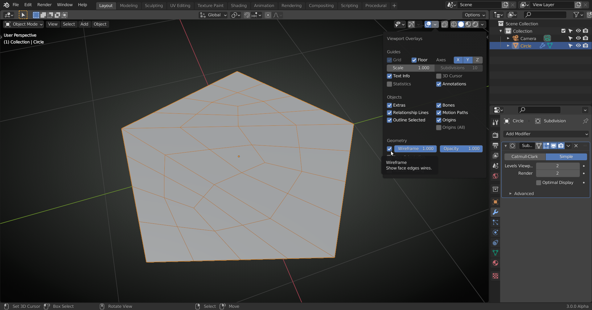

    Or enable the Wireframe Overlay here:
