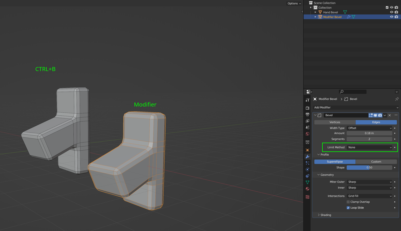

    Ah, I see!
    The difference is, that with the manual Bevel, you had all Edges Selected (and thus Beveled). To get the same result with the Modifier, you need also Bevel all Edges:
