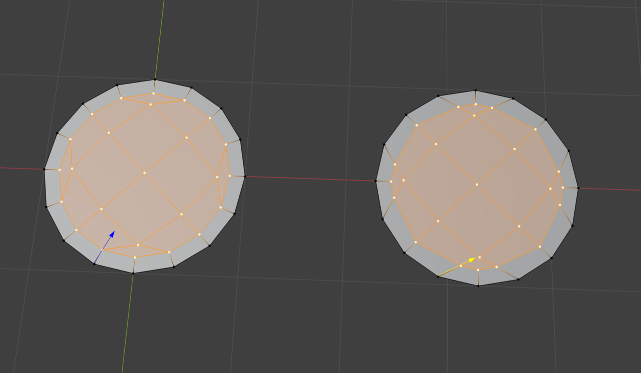

I don’t think your issue has anything to do with Edge Rail (which I, I must confess, have never used). What Edge Rail does, is best shown in an example; the left Inset is ‘normal’ (slides the new Vertices along the Normals) and the right Inset has Edge Rail enabled (new Verts slide along existing Edges):
