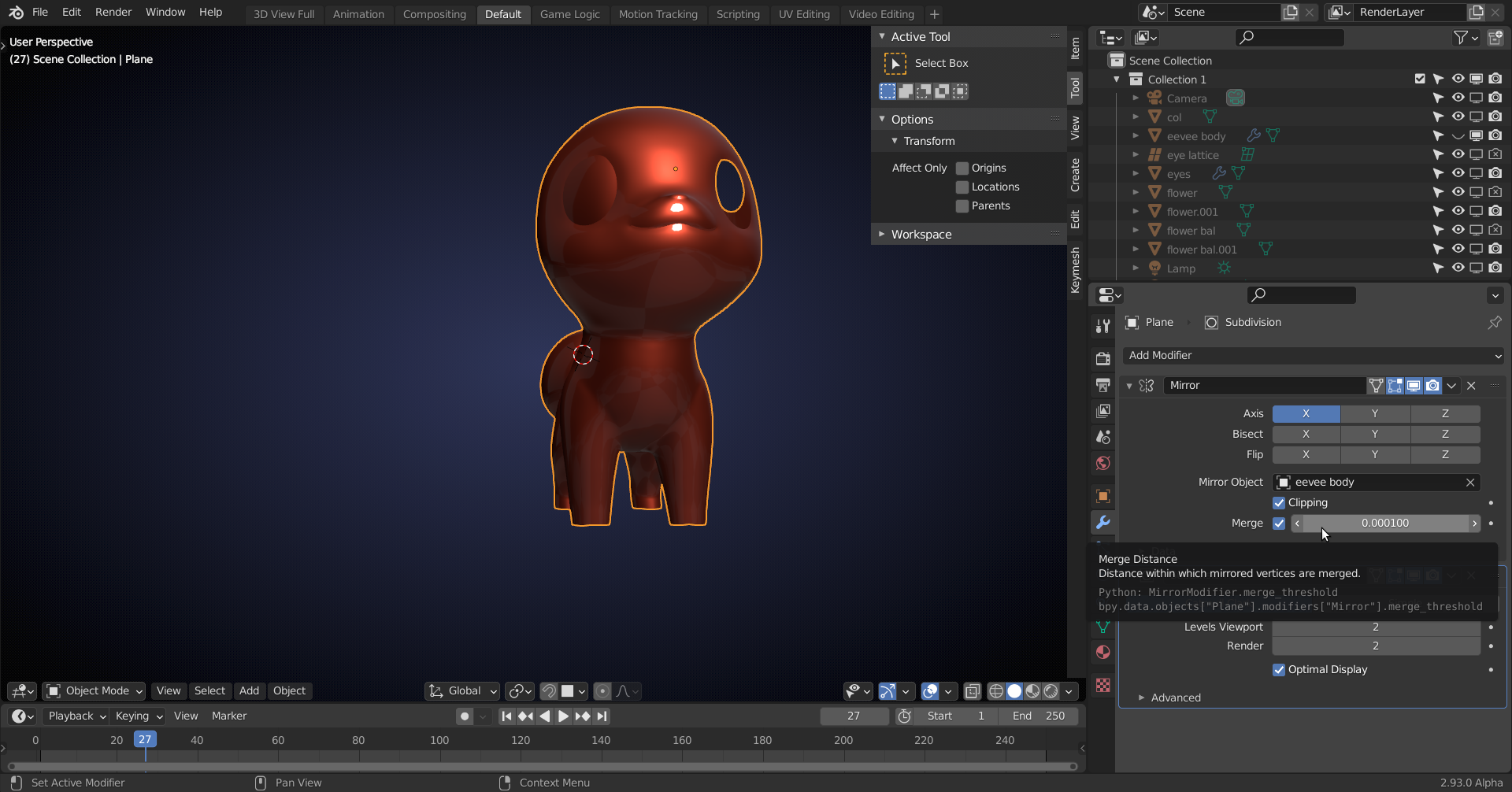

Hi Yuki,
I think it’s the Merge Distance in the Mirror Modifier. You seem to have it at zero. Try increasing it a little. I think the default is 0.001, but even 0.0001 appears to solve your problem:
