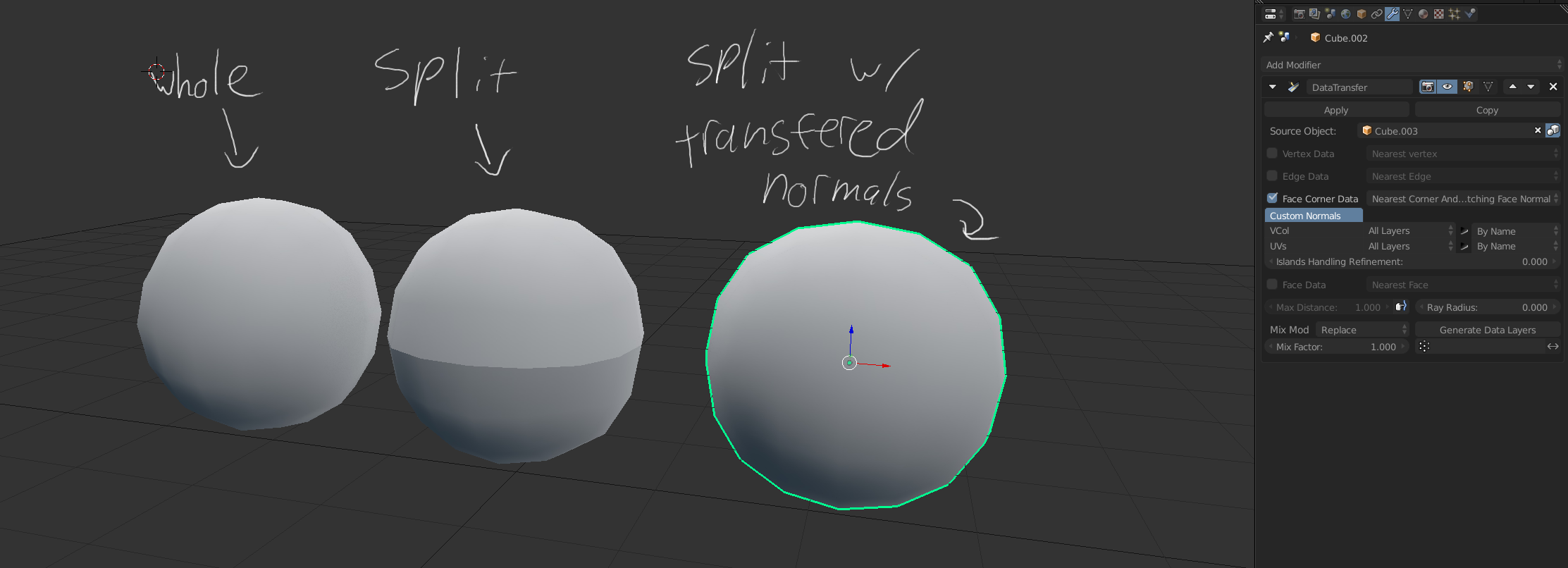

    Could I somehow transfer whole object normals on splitted ones?
    Hey, you nailed the exact solution! The Data Transfer modifier can do just that. I’m not sure how to make this non-destructive though if you’re working with multiple objects, so it’s best done at the end of the workflow.
